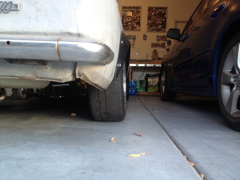

Post by PoorMtnKid » 26 Jul 2013 21:37
Well Dave, I guess I was not as low as I thought I was.
This is after eliminating the unnecessary parts Sleepy talked about.

Post by okayfine » 27 Jul 2013 06:57
Not that high for a street car, but it definitely wasn't low enough for a track beast!

Post by Sleepys-14 » 27 Jul 2013 16:19
Good job! It looks to me like you just added some negative camber and toed it out a bit, which should give you the exact adjustments that you need. I would set the rear to about 1.5-1.8ish. I am at -1.9 and need to take just a hair out according to tire wear.
