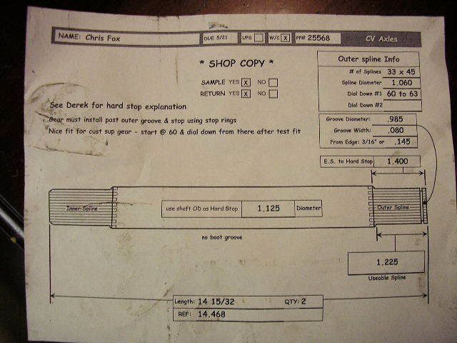

How long do the axles need to be or how much are they shortening t he ones that are listed at th3e beginning of this thread?
Re: Installing Mattndew's 510 CV axle adapters
The dimension is on the drawing in the first post...

I have a set of VW Vanagon axles. I sent them to be shortened and re-splined. The machinist felt he could not do the splines like the VW axles have with a built in shoulder. (splines are cold rolled into the axle before hardening- create a shoulder) He said that w/o a shoulder for the CV joint to butt up against, he felt the axle would "walk" back and forth after a while. (.020-.025 max movement) His cutter left a rounded spline end. I told him that I was not going to use these axles in competition... just street use. Anyone else run into this problem when shortening and re-splining. Note: The Vanagon axle is 27mm OD. Same diameter as the splines.
- Posts: 208
- Joined: 11 Jan 2009 19:48
I had the same thoughts. The shop copy that had been posted (not mine, but I downloaded it for reference and repost here) shows the shaft diameter (1.125") to be larger that the splines (1.060"), allowing for a hard stop. However, the splines on the Vanagon are the same diameter as the shaft. Coming inboard the cv would still run out of spline groove, but perhaps creating wear.
I'm not sure if this shop copy was from a different-sourced shaft or not. I don't have my calipers handy to measure the Vanagon axles I do have next to me, but they are the same diameter from end to end.
I would think an inner groove could be cut for a larger (o.d.) snap ring to create a hard stop. I will try to make time to ask about this next week.
We talked about the groove and snap ring. My concern was strength. I do not like the idea of a groove 'after' the CV joint. It forms a perfect stress line for the axle to break.
I wonder... If the axle is "fixed" at the other end, will it be allowed to move? (maybe the CV joint will move a bit?) I think by using the fixed end (stock with a shoulder) at the diff side and the 'loose' axle on the wheel side would work the best. What do you think?
