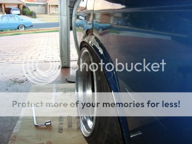

A guy over here is doing a similiar thing. I think he is finding it hard to panel beat bog though :lol:
No doubt he'll need to take a bit more out to get some suspension travel, unless camber does it job.

Postby ichorid » 06 Mar 2009 16:36
oh sweet that lip is just what I was thinking for the rear. thanks for the pics. Ill have to have some fender rolling fun when I get the car back from its swap.

Pedro wrote:A guy over here is doing a similiar thing. I think he is finding it hard to panel beat bog though :lol:
Looks like he removed the first lip and rolled it out
