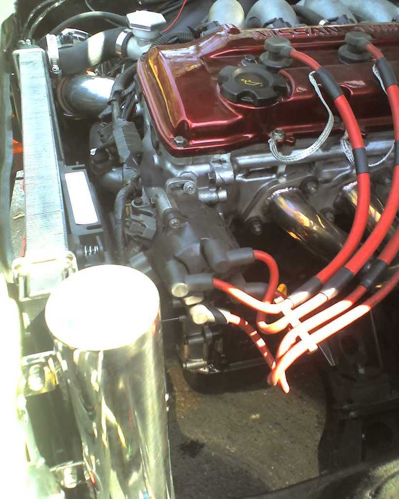

Post by DannyQ » 13 Apr 2009 16:07
I've been running a ka24e for 3 "seasons" now, the rad application is from a 78-80 vw scirroco ( make sure its the one with the rad cap, later models used a overflow tanks with a seperate cap) Its been doing a fine cooling job I wired up the factory vw coolant temp switch via a relay to power up my electric cooling fan, its sits perfectly in the rad support using the vw rad "rubber cushions" and rubber insulated mounts to fasten the upper section... I think it cost me less than 200.00 for everything... The hoses line up perfect, the only issue I had was the "overflow" spout on the rad cap had to shortened slightly so that it didn't hit the rad support when I screwed it on.
bleeding the cooling system is a little trickier, I removed the coolant temp sensor and finished topping it up from there to remove an airlock...
In traffic, guage never goes above 1/2 and the cooling fan keeps operating temp consistent. :D

Post by SeanT-wagon » 16 Apr 2009 00:11
Clutch fan and shroud will not fit without major modification to either engine location or radiator location. KA24DE mounted with a reversed crossmember and stock 510 rubber isolators to 240sx mounts (typical KA swap). Radiator is a sciorroco/rabbit radiator without radiator cap (in-line cap makes bleeding easier).
Electric fans would be the only way to really go for this swap.
