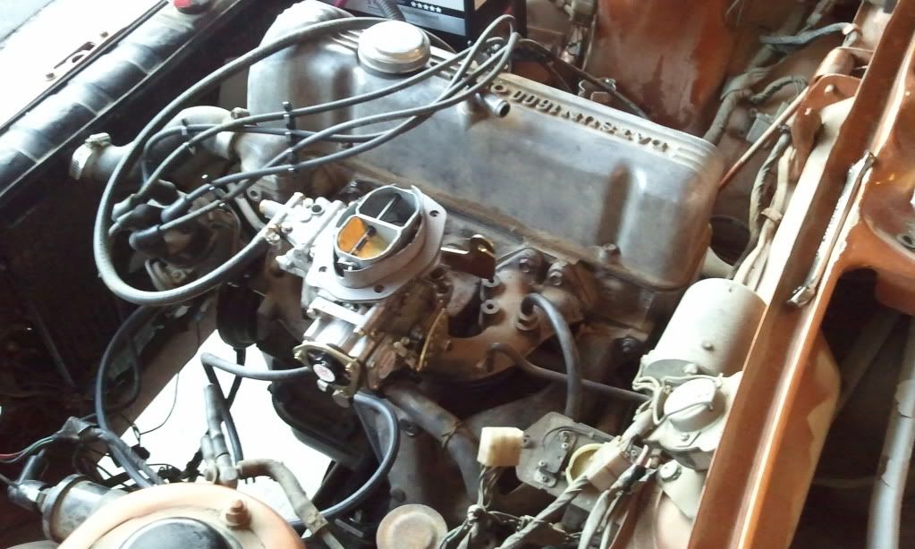

here r some pics i took with my phone, i took them real quick before it got to dark, not the best quality but i will have better ones soon, i also think i have a vacuum leak somewhere, cause im chasing my self around with tuning the carb, and i did try to hook up the factory throttle linkage, the part on the carb fits, but the cars throttle linkage pulls the opposite way of the weber carb, so i will need to do the throttle cable conversion.ImageImageImage

that last carburetor is a solex

Post by Creepy Cruiser » 11 Dec 2010 12:12
If I remember correctly, you can flip the main rod so the ball is on the top instead, and it will rotate the other way. Just make sure you put on the washer and put the cotter pin in, so it doesn't fall out of the carb end slots (because it will be sideways now). Again, this is all stuff I'm trying to remember how we used to do it back in the 80's, lol

Post by brad8401 » 11 Dec 2010 13:49
Lol wouldn't even think of that, i will have to try that as soon as i get home from eating.
