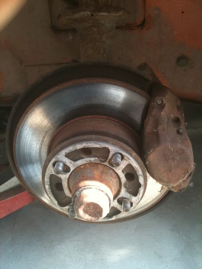

Aren't the front brakes on the Z's solid rotors where as the ZX comes with vented rotors?
1972 Yellow 4dr
datzenmike
Posts: 5572
Joined: 24 May 2006 12:40
Location: Van. Isle.
Re: 240/260/280z struts
Post by datzenmike » 25 Nov 2010 18:55
Yes.
Here's the hub with what I think is the S30 caliper.
"Nissan 'shit the bed' when they made these, plain and simple." McShagger510 on flattop SUs
