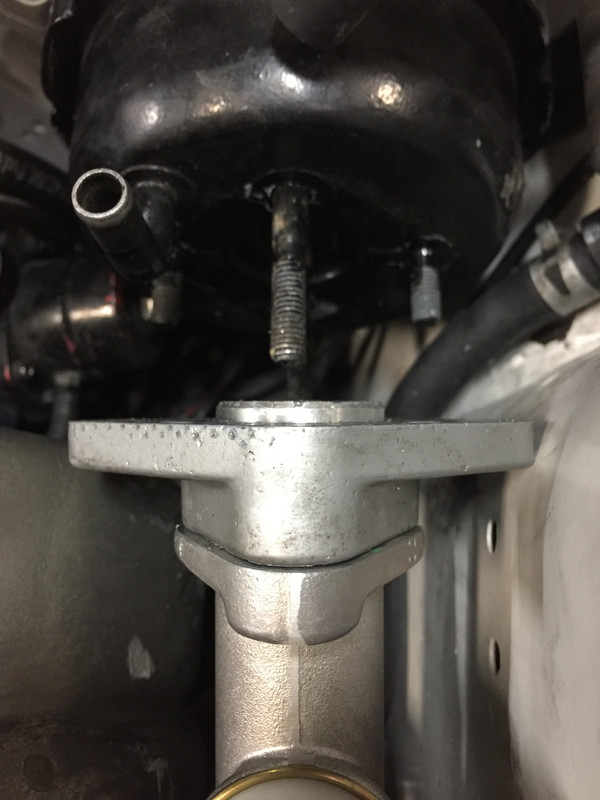

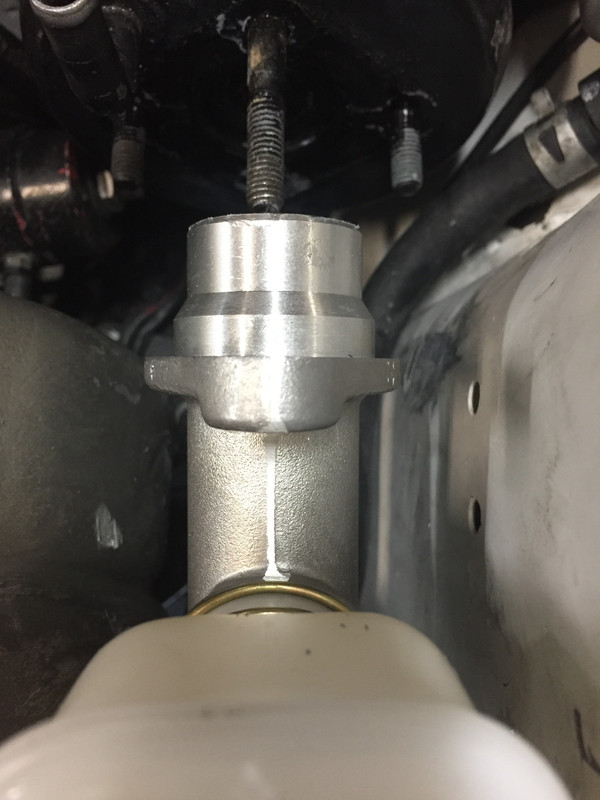

I'm still at it. The brakes still have a lot of weak pressure on the first part of pedal travel and then hard. I have managed to make them work with effort, but that's not why I installed the booster.

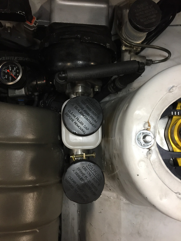

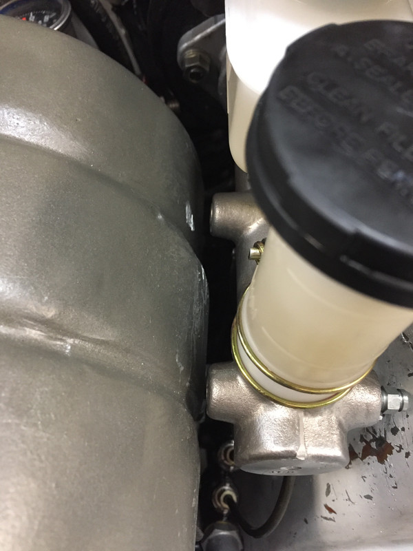

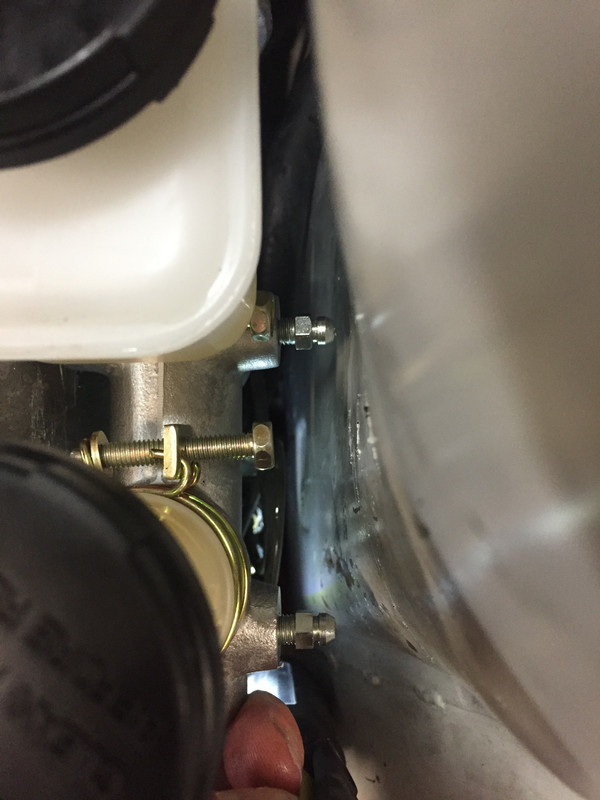

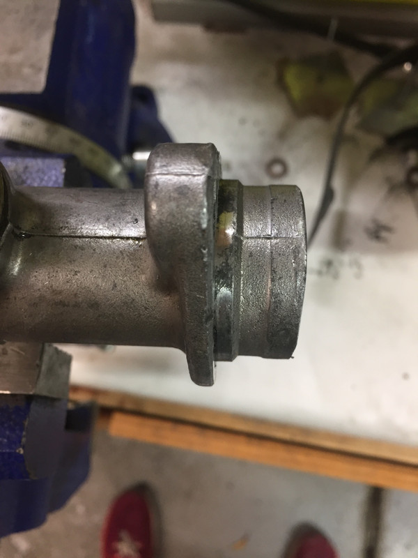

To alleviate any wrong parts matching on my end, I decided to get a 7/8" MC from an S30. Unfortunately, this has caused some different issues. I was under the impression that nearly everyone runs this combo of parts. I can't image how that's possible with the added length of the 7/8" MC at the rear. Mine does not fit the B210 spacer like the 15/16" unit does. Every 7/8" unit I see listed is the same as mine. I think the combination will work if you bore out the spacer at the end, but I've never seen anyone post information about this. What am I doing wrong now?
B210 MC spacer
15/16" MC from 280ZX
7/8"MC from S30
The only good news is that with the bleeder ports facing the shock tower, I don't have to modify anything to fit this MC. That is, if it even works.

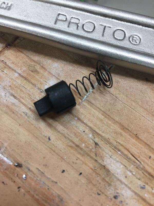

Last question; are you supposed to remove these rubber "stoppers"? Everyone says they are there for drum brakes to hold pressure in the line, but there is one in each port front and rear. They also don't seem to do much. If anything, they would allow pressure into the lines from the brakes, and not from the MC since they seat facing down.

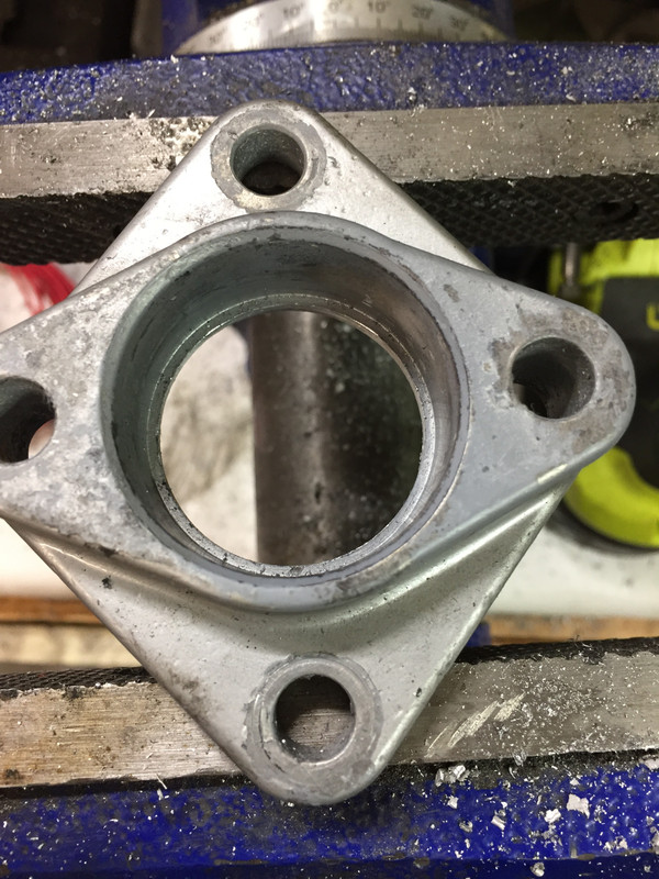

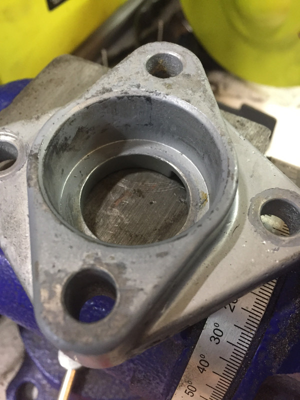

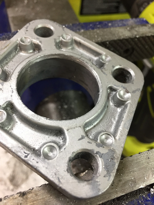

I found a single reference to my issue of fitment in an old post. Either open up the spacer hole, or use the S30 spacer. I don't have an S30 laying around, so I used a step bit to open it up. Here is the result.
It certainly fits much better than the 15/16" unit. However, I still do not have better braking. The pedal is still soft on initial travel, and then hard. There is no modulation to the travel and I'm at a loss for a fix.

I vaguely recall opening that hole up as well back in the day.
As far as the spring check valve/residual pressure valves go, I removed the rear one when I got my new master. If there is one in the front, it may be a lower spring pressure but I can’t say for certain because I never looked at mine.
