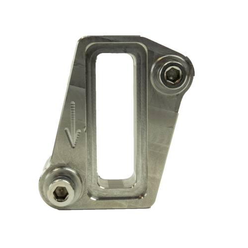

I've settled on using the R35 slot style maf long ago so now I needed to figure out the details on pipe size, material, routing etc. This sensor allows airflow in axially and expels it radially back into the flow which makes it robustly reliable against reversion during shifts on a turbo car. With a 3" tube, Nistune has experienced a maximum of about 320rwhp which is perfectly sufficient for this build and provides good resolution. There are weld on slot style maf adapters for a bunch of different piping diameters so it is important to get the correct one so the radiused contour matches the tube size and so that the sensing guts are placed in the center of the tube. I originally hoped to use 2.75" tubing for the MAF yielding ~270rwhp max (scaled by the pipe area ratio) and allowing less pipe size change to get me down to the 2 3/8" turbo inlet but there are no MAF adapters for this pipe size so I abandoned that plan.
Adapter:

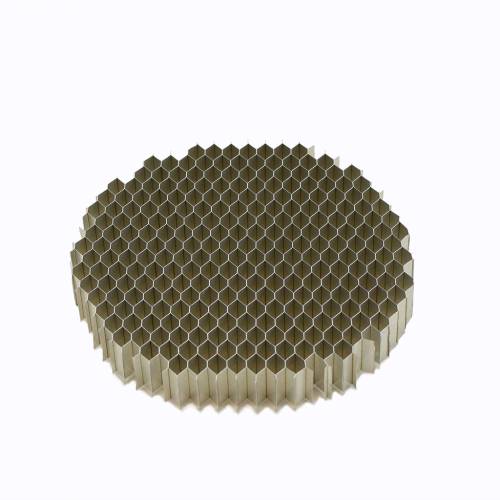

OEM MAFs use grating in the inlet and sometimes the outlet. Hitachi's patents call it "upstream flow rectifying grating" which is probably a more accurate description since velocities in the tube are too high to accurately call it a flow straightener (which is traditionally for laminar flow). Its objective is to introduce a minor amount of turbulence throughout all operating conditions to knock out eddies and vortices which mess with the sensor linearity. With that said, I am going to run mesh on my pipe inlet right where it receives air from the filter and match the distance between the sensor and mesh to the OE plastic housing. I want to do everything I can to have the best sensing possible since measuring the airflow accurately is really the backbone of a good tune.
MAF flow sim without mesh: https://www.youtube.com/watch?v=0_-7ggnURSc
MAF flow sim with mesh: https://www.youtube.com/watch?v=R1y0O-3RNVg
"Flow straightener" mesh:

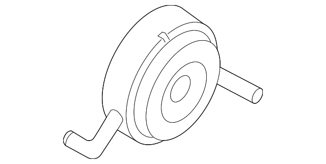

I originally wanted to run an RB25 filter adapter with the OE oil--> water cooler but there is not enough room under the intake for the whole thing.
RB25 cooler assembly:
Some SR20DETs come with a similar (but shorter) stack o pancakes cooler. The flagship Pulsar GTiR comes with a cooler the same size as the RB25 and RB26 which are all almost double the thickness of the SR20 cooler.
In recent years, it seems many OEMs have gone with oil coolers to help facilitate longer oil drains since oxidation is the fastest killer of engine oils. Some of the newer Nissans utilize a similar cooler to the 90's ones that bolts in between the oil filter and the oil filter mount. If there is sufficient clearance to the lower intake manifold, this will be a pretty elegant solution. It'll probably require a custom machined bolt to assemble but that's not a deal breaker.
I also feel much better running smaller, cheaper, lower pressure, and less-critical water lines for an oil cooler over and Air-oil cooler with all the lines and thermostat to go along with it. I figure a V6 or V8 OEM oil cooler will be sufficient cooling for my street build. Perhaps in the future I'll build a 5-6qt (stock is 4 with filter) hammerhead oil pan to improve ground clearance and cooling but we will see where this goes first.
VQ35/VK56 cooler:
Interestingly enough, Mopars have been using an almost identical setup to the Nissan one in everything from Jeep Liberties to Dodge Challenger SRT8s. Funnily enough, the SRT8 coolers are 19 layers just like the RB25/26/GTiR coolers!
Chrysler 300 owners install the "police package" oil coolers to reduce oil temps during spirited drives and claim reductions from around 250F to 225F and see oil temperatures drop much faster than without a cooler.
Between the large displacement Nissan and Mopar coolers, I'm sure I'll be able to find something suitable. Obviously this will put more stress on the cooling system so I'm in the market for something with higher capacity there as well but that's a job for another day.

On the NA side of the intake, I want to be able to run an R35 MAF when NA since changing everything at once (which includes MAF, injectors, KA to SR management/Nistune with individual coilpacks) would result in a nightmare so I need to be able to change things one by one in the following order:
1) NA with SR management/KA MAF
2) NA with SR management/R35 MAF
3) NA with SR management/R35 MAF/upsized injectors
4) Simply add boost!
So I've now crossed off a SS intake tube from the bucket list even if it is only used for a short time. It's set up so you can easily change MAF/filter setups as you can see. I still need to purchase a 3 --> 2.75" silicone coupler for the R35 MAF purpose.
