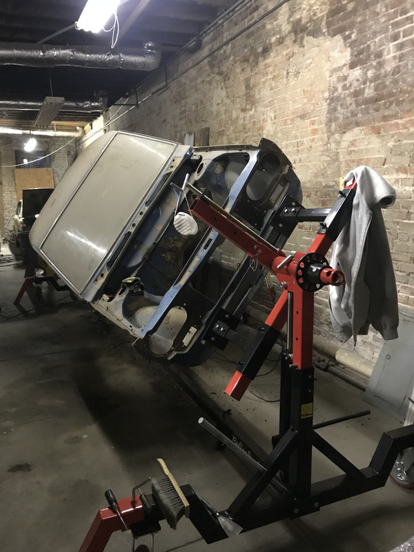

Post by edekalil » 04 Nov 2019 17:09
Couple more pics of the car on the rotisserie.
Using this small putty knife to clean / chip off the old undercoat. Not in a rush but it’s coming off purity quick.
Little by little when I’m in.

Re: 2door all apart
Post by MikeY » 04 Nov 2019 19:20
I find a little heat helps. I usually have a blow torch in my other hand. It will catch fire once in a while.but.never burst into total flames. Lol. Ant then a paint brush and some solvent. Gas works pretty good. All of it makes quite a mess. A final wipe with gun wash and it's pretty much ready for primer.

Post by edekalil » 08 Nov 2019 19:55
Thanks for the advice, I just got a heat gun, but also have a torch in the shop but because it's all in my Historic building I'll only use the torch if I really need it. I also have a butaine torch like plumbers use it may be safer.

Post by edekalil » 12 Nov 2019 18:35
Thanks for the suggestions, I used the propane torch I use on plumbing for copper pipes. It worked good for the tuff areas. Most of it's done but still have some left to do as well as the wheel wells. Using the torch does make it smell up the place but some airing out and it was fine.ill be back for a few days next week so I'll get more done. Several areas it just about fell off, was very loose but no major rust under so I'm pretty happy. The floor pans will need some work, I went to see a welder friend about comming by to maybe enlist his help some. We'll see.

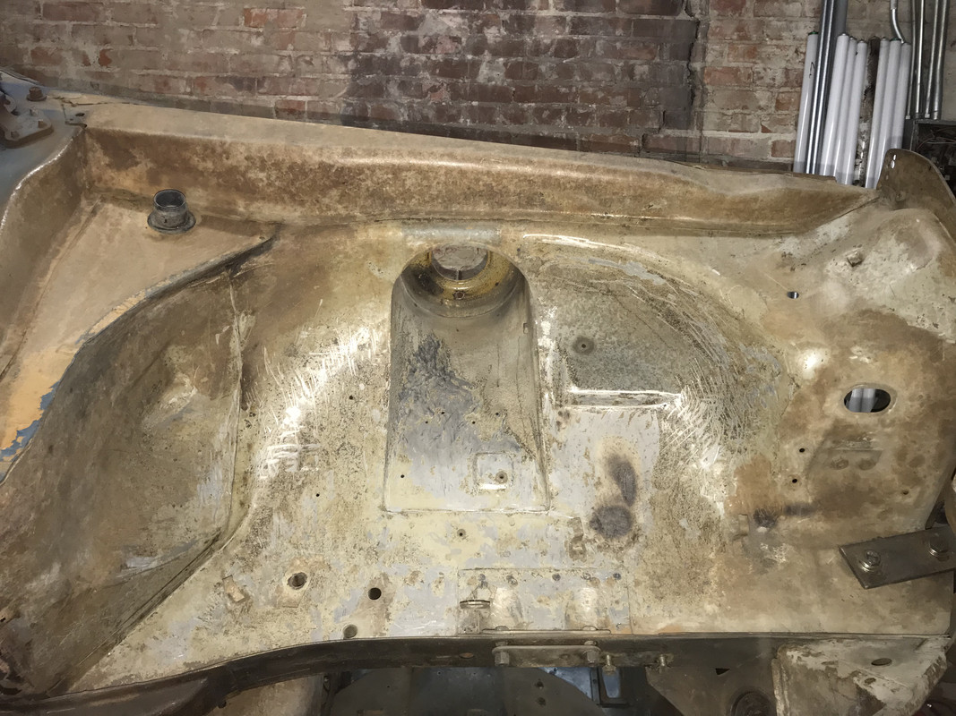

Post by edekalil » 06 Jan 2020 16:14
Thank you Baz and Tracy.
I got most all the undercoat off now.

Post by edekalil » 27 Jan 2020 07:48
Some pics of after scraping off the undercoat, there are some more places I have to get to that are confined.
Still more cleaning needed. Will slowly work on that here soon. The rusty look under I believe is not accully all rust.
