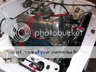

Installed engine and other parts. Still looking for a side draft carb but I need to do test run so I used stock Hitachi carb and stock fuel pump. It is getting colder here and I cannot do much in my garage.

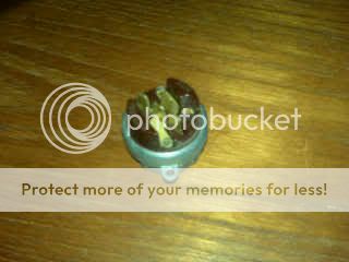

All original wirings tested and installed and most electric parts were replaced to new ones. Without gas line connected, I tried "dry run" but (as expected) starter does not start. And lower beams stay on. I need to go over the wiring again.
Is there anything electrical I should check when 3-spd column auto is replaced to stock 4-spd trans? All three terminals (+, -, Ign, with wires removed) on starter solenoid have continuity to ground. Is this normal?
Hairpin-Circus......
We Do It In Corners
Posts: 11830
Re: Going Back to 70's
Postby Byron510 » 03 May 2009 15:59
NO, there's definitely a problem.
The auto harness has a switch that interrupts the starter lead when not in P or N. So this line needs to be connected permanently, or better yet interrupt the ignition wires in the harness as it goes above the motor, beside the wiper motor, and solder the wires together.

Postby PMCS Rally » 17 May 2009 17:17
After going through each and every wire, relay, switch, and connector, it was a broken terminal on ignition switch. Why didn't I think about it first?
