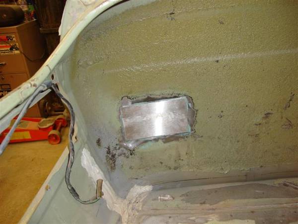

Dad found a spot in the trunk with a pin hole, yet the metal around the spot looks fine - quite strange. It’s right above the muffler, who knows - maybe something happened there in years past. It’s patched now. Dad took care of the work in the welding department. Then he started some panel beating on the front valence... see below...

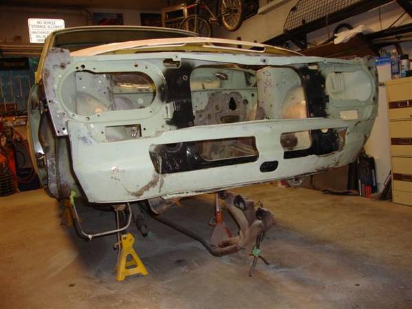

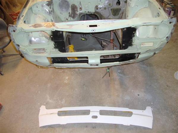

We decided that the front valence is not worth saving, so I'm going to install one of my fiber glass units and make it a bolt on - I haven't decided yet if I'll make the nuts captive. I've done this in the past and it works well. Of all my glass parts, this part I like the best!
I also placed a different set of front fenders on the car. These ones I picked up at Canby three years ago - $400 for the pair. They are pretty darn good, but we'll need to take the undercoat off the back side so that proper paint can be put on the in order to make them last. Also some one decided to shave the marker lights, so the hole had been filled. Shawn decided to go with the smooth no marker light look, and we glued panels over the rear quarter side marker light holes tonight. I'll fill them flat next time I'm out there.
Car is coming along. I still have to decide what hood to use. There are a couple of options available to me. A spare that I painted for the Bronze which didn't get used, the yellow one that came on the car (many coats of paint and some bondo...), and I have one more that needs a little work but is all original in the paint department so no real surprises.

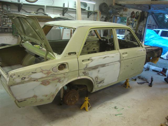

Drivers side up to the doors ready for the K38, you can see where I was blocking out the "phantom" body l;ine below the supersonic line - it's easy to loose this one, especially on panels with more than one layer of paint.
Shawn’s first hand at flattening panels – his trunk lid, 2/3ds done…
I got going on the pass side rear quarter and the top section of the door. The car was riddled with little stone chips, and if you sanded to the metal each had a little rust spot under the paint, so this is why all the polished off spots on the car – sometimes I think I should have just bought a couple hundred dollars of paint removing wheels and started from the metal up!
I think I’m throwing in the towel on this valence panel – it’s not rusty, and I’ve fixed worse, but since I have a lass replacement, it’ll just be faster to replace this panel and call it done…
No photos, but dad spent the time to polish the metal on the inner fenders, and then applied a coating of rust mort on anything that even started to look like surface rust. He also did most of the area inside the cowl vent cavity; Just a preventative step to preserving the car a bit longer.

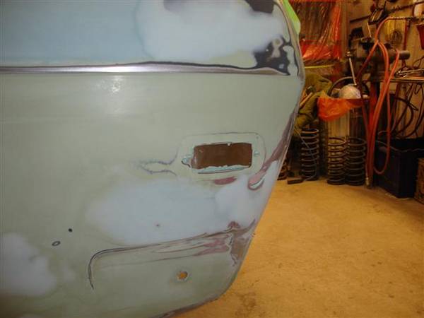

So, we ended the last work day gluing in the blanking panels for the rear marker lights - we’ve gone for the shaved look. There was some stainless lying around - dad cut up the pieces and we glued them in on Saturday so that the glue could set well and undisturbed.

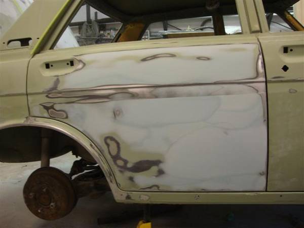

Today I started the task of filling the holes. This didn’t take too long, but as you can see blocking the fine supersonic or phantom line is always tedious. You can see the black spray bomb I used as a guide coat to find the line on the driver’s side – I was using a pencil to lay down the guide for the pass side – didn’t show in the photo...
The pass rear quarter also had a different problem – someone had filled and pretty much sanded the phantom line off the car, so it was a bit of a challenge getting it back – more panel beating happening in the process as I found the high spots.
Then I moved onto the only really damaged panel on the car - the pass rear door. I thought I'd done a pretty good job of pushing out the dent, but after 3 hours of work, I realized I got it wrong. I had to off-dolly a couple high spots and then the panel "popped"… and I started all over. The various layers of filler are visible, but there isn’t a spot on this door that has more than 1/32" deep.
The photo doesn’t show it, but you can see the paint through the filler in most spots it's so thin… I spent 6 hours on this panel! My arms are killing me. I can't wait to go back to work and take a rest from my "week off"!
So a shot down the pass side shows my next panel to attack, we’re getting closer.

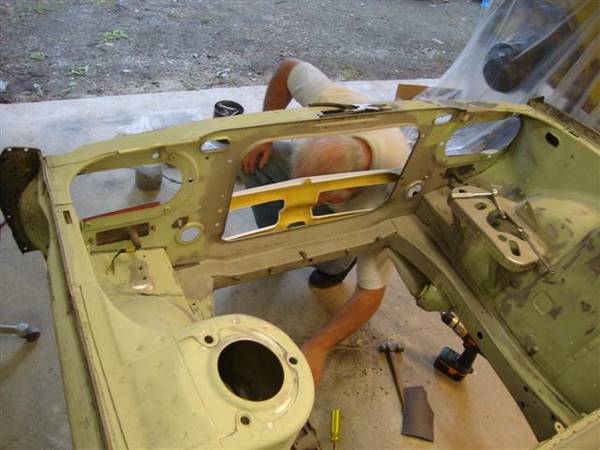

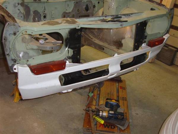

Dear old dad got to work on the one damaged panel that we decided to scrap- the front valence. He cut off the sheet metal this morning and started the fitting process. He got into it for a couple hours before getting distracted, but he’ll likely to get on it this week. It must be good to be retired and do things at your own pace. Unfortunately my time is limited, so when I’m there - I go like hell.
This photo shows the captive nut placement – these wil get welded into place to make this a bolt on panel. I did this with my first true resto on my green 68, and it’s a very good mod.
This past week was a good upper body work out, I can tell you that. All work has been done by hand with boards and blocks. I have a DA, but it doesn’t get used a whole lot – not too good for keeping panels flat. The boards and blocks do a pretty good job of keeping the lines, but there is a physical price. I bought a nice new 3M board last week – it is nice and the bridge is extremely stiff, so flatness is easier to obtain. However the progress is good and I can start to see the light at the end of the tunnel. I’ll be happy when we’re both blocking out the high build, and then the nerve racking, but immensely satisfying job of putting down the colour :D
