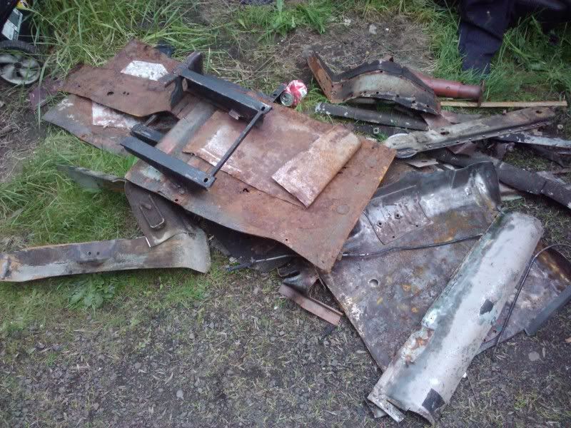

floors in
bye bye

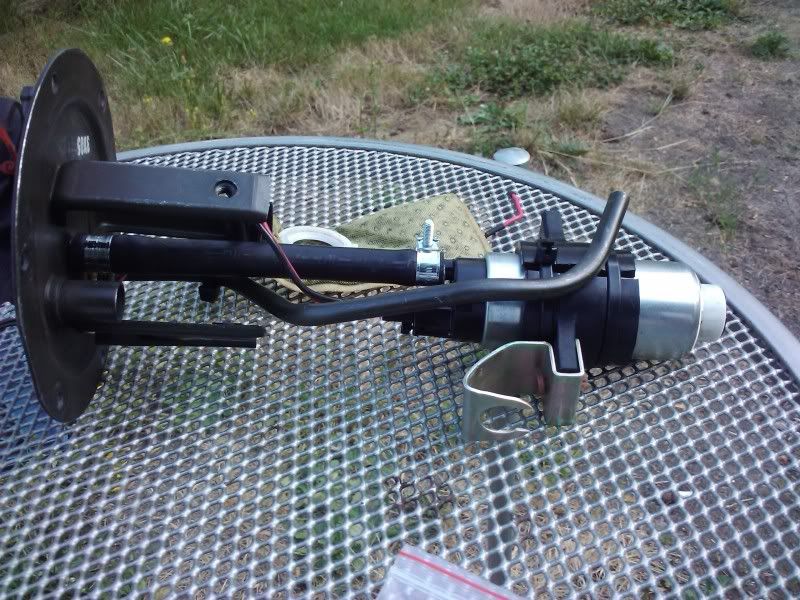

so my walbro froze a . Have any off you guys used a aeromotive 340 on your sr cars. Is it as loud as a walbro?

phil came over and fix my harness. He rock's
My buddy kyle sold me a aeromotive 340 with a z31 pump stand and his custom mounting bracket. It just so happened he had bought a bunch of fuel pumps so he could design a pump stand for z31's that could hold 2 or 3 fuel pump's in the stock tank.
here is how ron had my old tank set up the pump mounted to the baffle

Postby dislexicdime » 29 Jul 2012 13:20
well this pump makes about 50% less noise as a wallbro . my ears are happy
