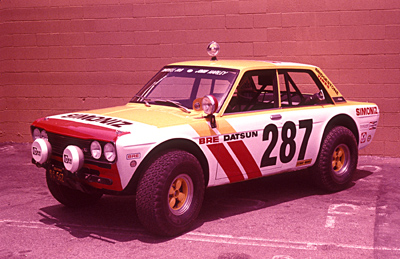

so I grabbed a set of the ebay metal fender flares. http://www.ebay.ca/itm/New-for-DATSUN-510-Fender-Flares-Wheel-arch-premium-sheet-metal-JDM-/232270228578?hash=item3614626c62:g:aP8AAOSwYIxYAP8u
the packing was great and I could still smell the paint off gassing as I opened the box. the production is spot on each flare has a corner designation. perfect for a 4dr.
they are made so well that they will only fit like in ......their pic :oops: Image
to gain clearance for the 27 inch tall all terrains my cut will need to be above the belt line..... :cry:
well.... they will make good templates for the ones I will need to make :?
if I finished off my arches like this : Image would I get harassed by the fuzz ?
