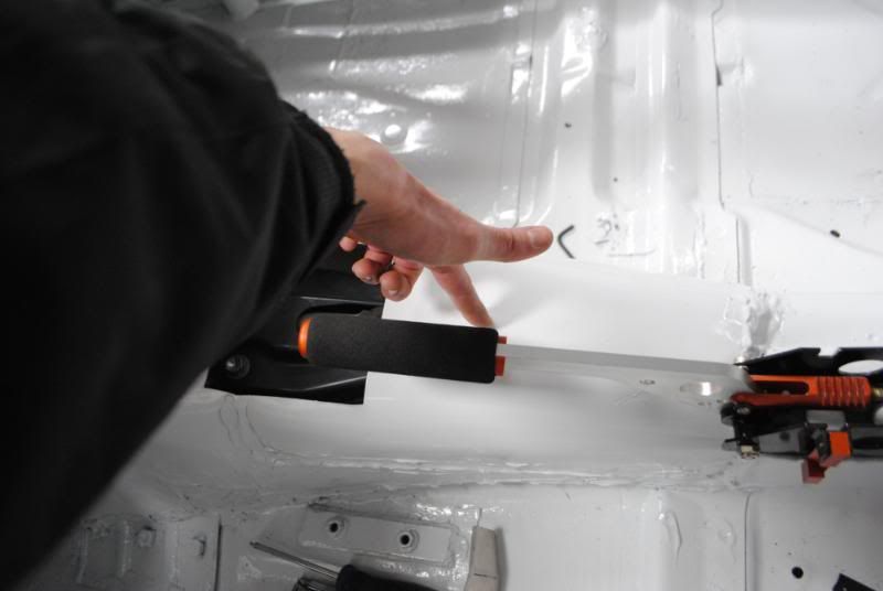

I decided to put the engine and trans together and give it a go. I picked the coldest day of the winter so far and with no heat ( ran out of propane). It is 8 degrees out in the garage and it is supposed to be -6 tomorrow night (-25 wind chill). Brrrrrr. But I did actually get some stuff done. I got the engine in the bay... and for the most part it fits pretty good. It is kind of a tall and slanted motor so it looks a bit wierd, but I am just happy it is all aluminum and pretty light (300lbs w/o trans and 170hp). Here are some pics...
This is where the stock oil cooler is kind of in a bad spot. The coolant hose is running directly in to the firewall. I will have to cut it off and weld a 90 degree elbow on it to get it to work. That is really the only fitment issue.
Here is the shifter location. I had the hole cut for my ls1 swap from before. I still need to cut it back couple of inches.

Is that the actual mounted location, or just a rough mockup? At that hight and angle it looks like you may have trouble getting the hood on,

It is a rough mockup as of tonight. My feet froze to the ground, so I had to come in the house and get some warm soup. That was the end of my night, nice and warm... MMMM. So, I was planning to get the front subframe under it tomorrow, but it is going to be so damn cold I might just take the night off. I really want to get the motor mounts and trans mount done this weekend though.
And about the pics, the back of the trans needs to go up about 2-3 inches, so that is why the engine doesn't look level.
