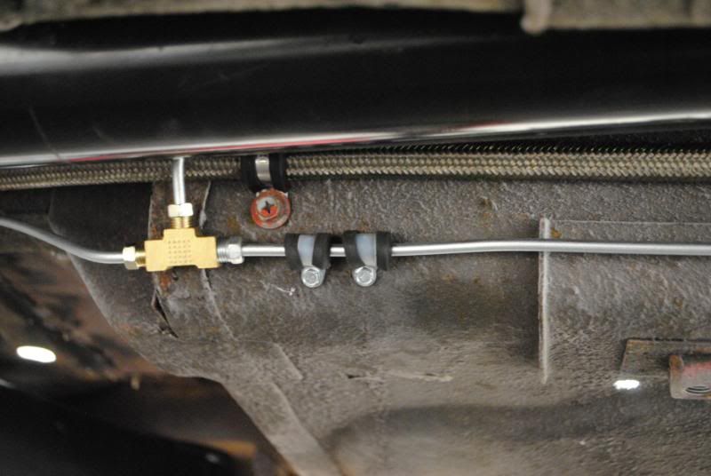

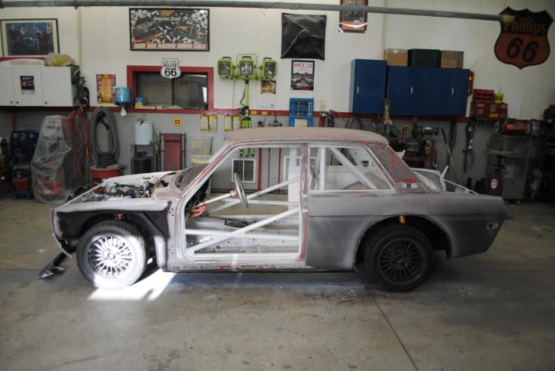

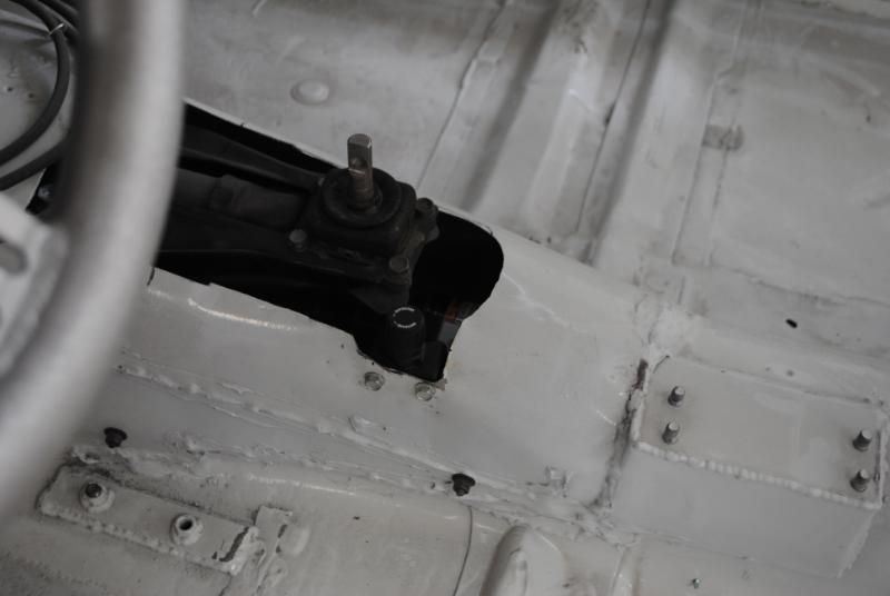

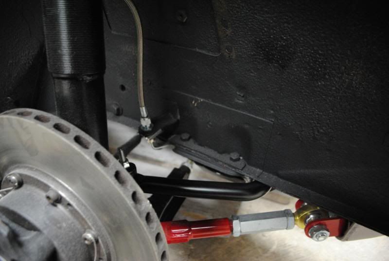

Well, I finally have some updates!!!! I have a ton of pics, so I will let the pics do most of the talking. Mostly because I can't remember exactly what I did... It has been so long. To start out, I made all of my brake lines and got the brakes all bleed out. I wanted to keep them nice and clean, so I kept the bends smooth and tight. Lines take way to long. I have about 10 hours in just the lines

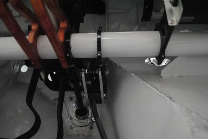

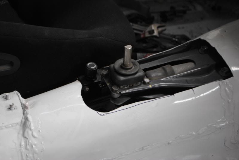

I put the proportioning valve next to the shifter for easy adjusting
Then I made an adjustable mount for my throttle pedal. This way I can adjust it up/down, left/right, and in and out to get it just right.
Installed my 1 inch swaybay

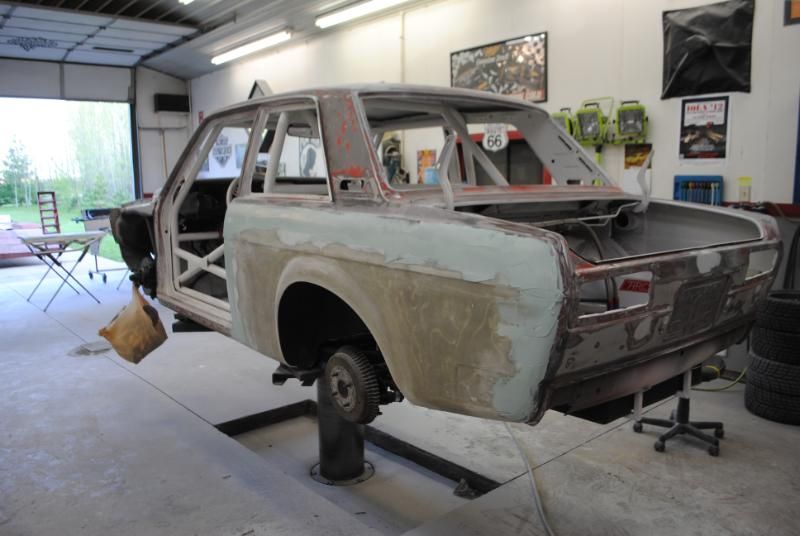

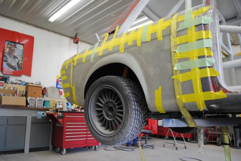

I got my quarter panels from Futo fab
To cover up this crap...
I also made a steering brace

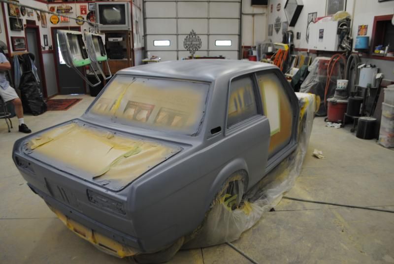

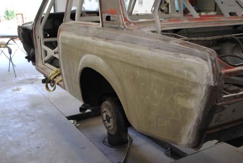

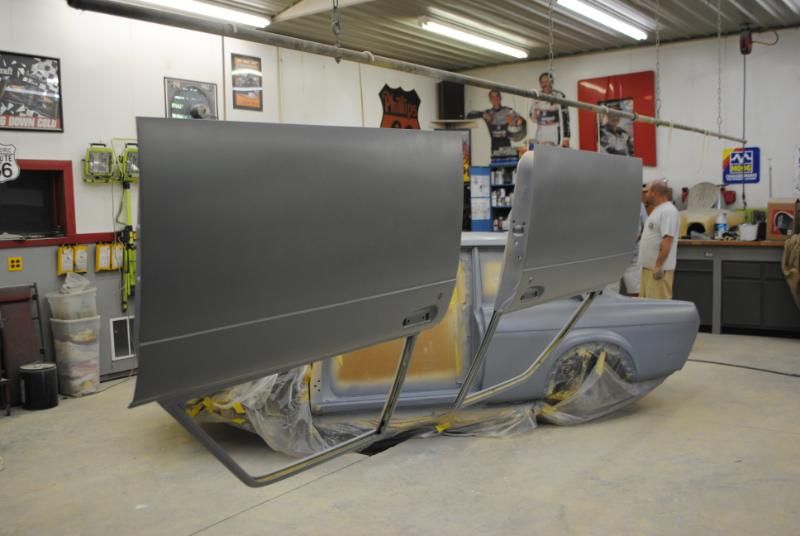

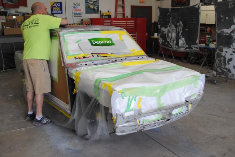

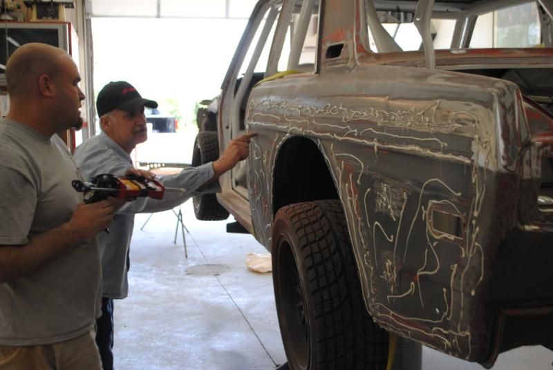

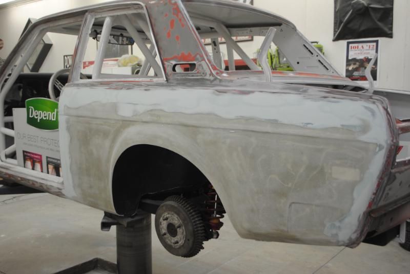

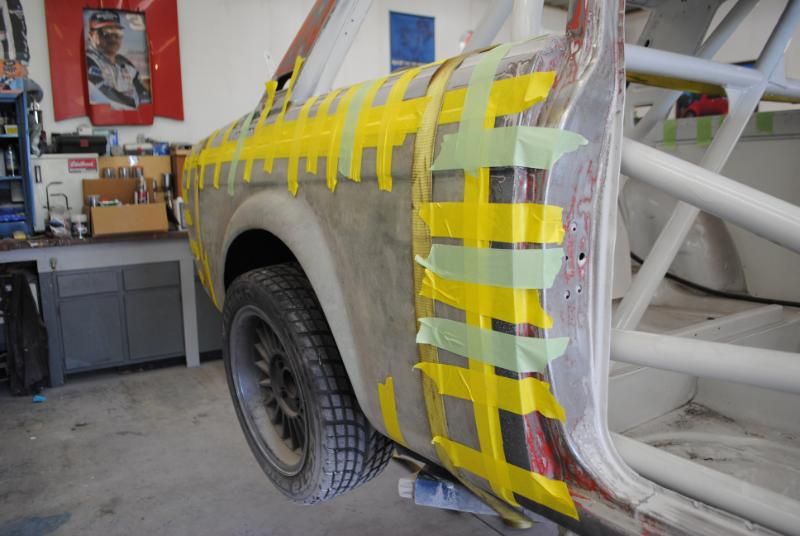

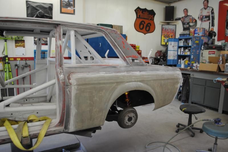

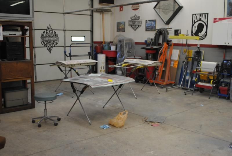

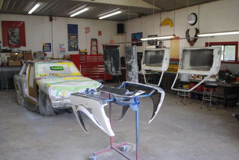

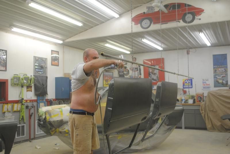

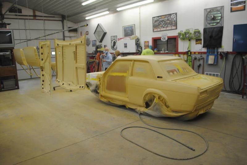

Fast forward to this weekend, when me, Dome, and Fran Did all of the body work and paint in 3 days. I am waiting to wetsand until I am done building the rest of the car, so I wont scratch the shit out of it. Warning, tons of pics.
Glued these bitches on
Sanding, Sanding, Sanding

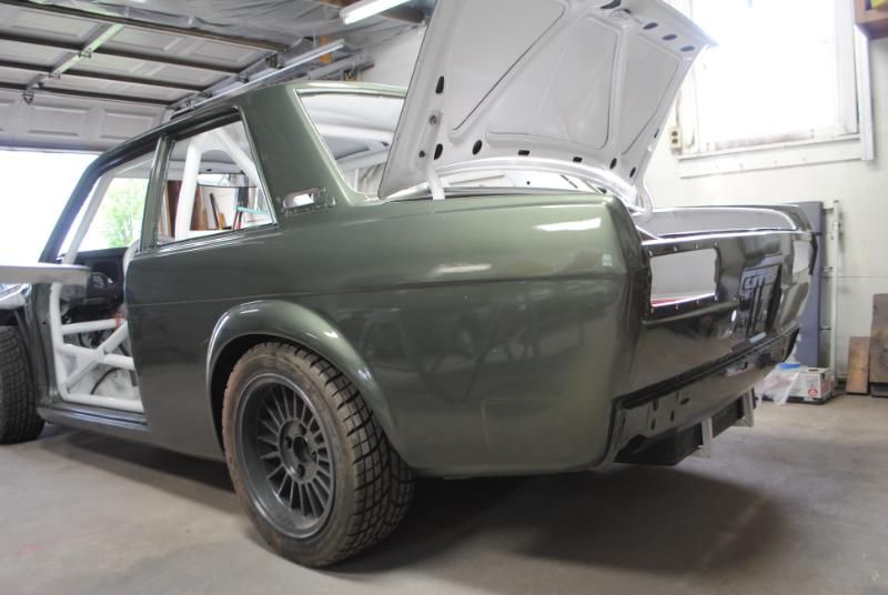

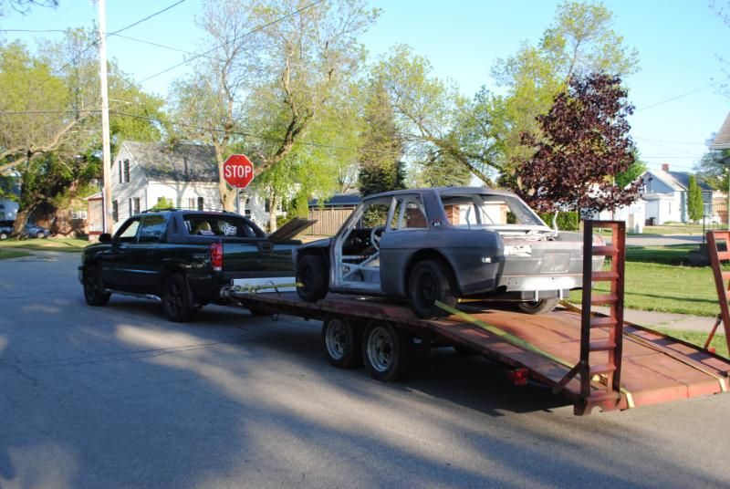

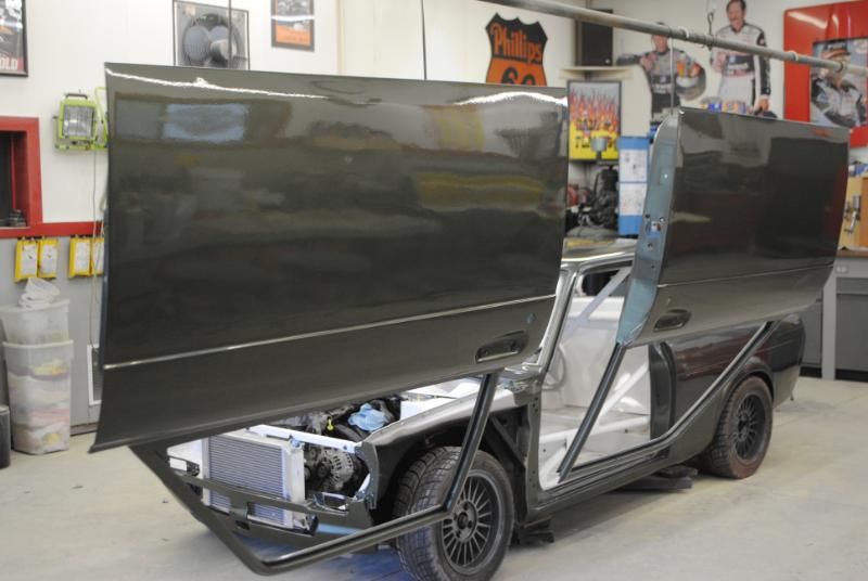

Post by Sleepys-14 » 16 May 2012 18:24

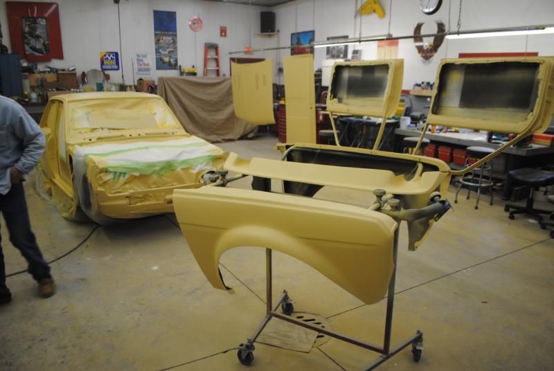

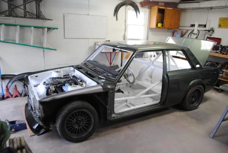

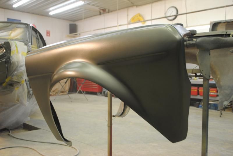

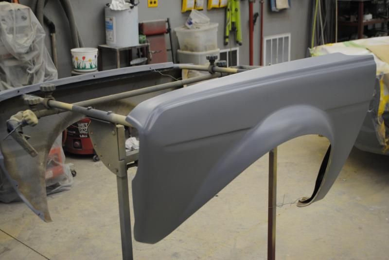

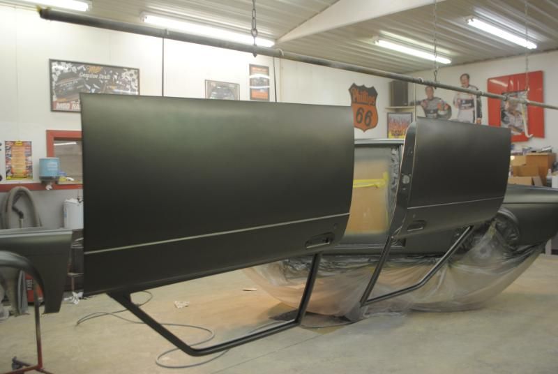

Back to the body work...

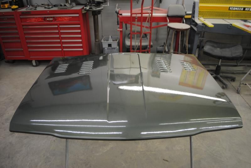

Primed
Sealed
Putting the base color on like a boss
Cleared

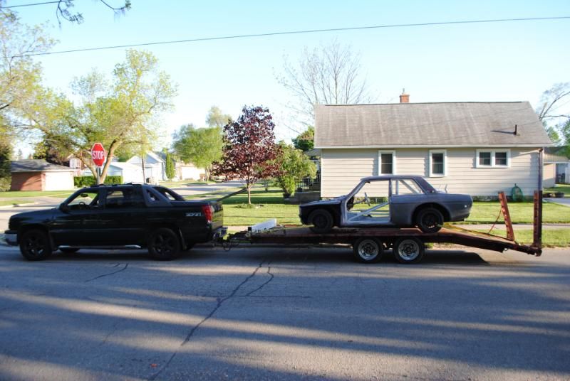

And back home in my garage!
I can't wait to wet sand the poop out of this!!!!!

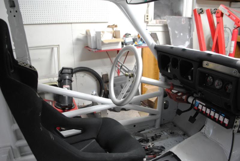

Finally, I've been waiting for this update. Holly crap sleepy, you been busy! Super nice job on those fenders too, really nice work all round. Specially like how the steering wheel turned out. has a heavenly look to it. :mrgreen:

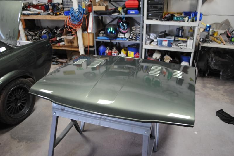

Very nice louvers

Were the wheel well cuts too large to accomodate regular flares? Why did you have to go with full rear quarters? I like the way it turned out. Preserved the "supersonic" line really well.
Sleepys-14
Posts: 434
Joined: 03 Mar 2011 11:26
Location: Appleton, WI
Re: Gordy's ecotec 510
Post by Sleepys-14 » 17 May 2012 12:10
Both rear quarter panels were hurtin' pretty bad. They looked way better in pictures... Plus the futo fab quarters have the correct wheel well size, instead of the rivet bre flares that make the wheel well about 2" larger.

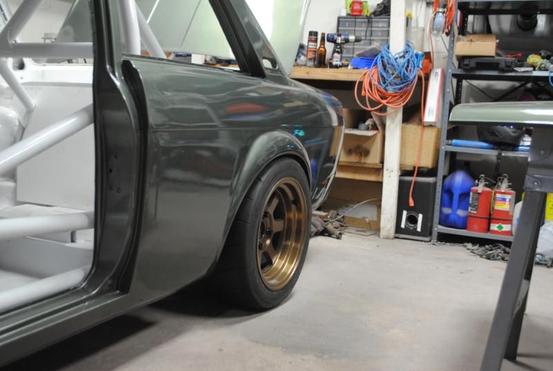

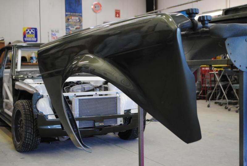

Post by Sleepys-14 » 30 May 2012 19:57

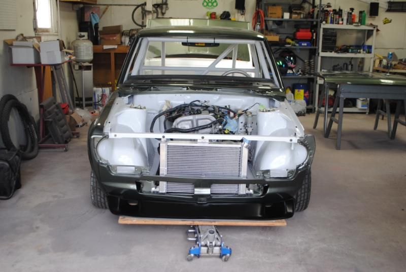

I will be taking a few weeks off from working on my car to spend some extra time with my wife, since she is going to be gone for 7 weeks for work. I plan on getting this thing done and running by the time she gets back. In the mean time, I will just be getting some things in order so I can get working right away in the coming weeks. I recently brought all of my misc. little parts( door handles, grill, trim pieces) in, and I sandblasted them. I am going to have them all powder coated black. I got my new wheels and mounted up my tires tonight, which makes the car look great while it doesn't even move under its own power. They are 15x8 et0 with 225/45r15 NT01's. I thought a 15x8 et0 would have been big enough for the front, but I still have at least another inch of room to go wider, huh. I guess I will just spacer them out a bit.
And yes, I still am missing this side fender because of a nasty run in the clear that we had to take the panel down and respray it.
