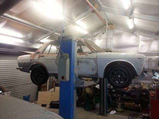

I think your exhaust is impressive.
Can you clarify your rim size? Do you have 16"x7.4" (190mm) with +34mm offset? Are all 4 of your rims the same size and offset?
I pray you go with R31 struts!
Thank you very much for taking pictures of the rims while the car is on a lift.

Thanks guys. It looks good because its from far away ha. There are a couple of joins that use mig filler. Ha. I'll get some close up photos for you guys later.
Rims are 15". I'll look for a size on them, might have taken a photo without tyres. I am going with 200b struts and custom hubs.

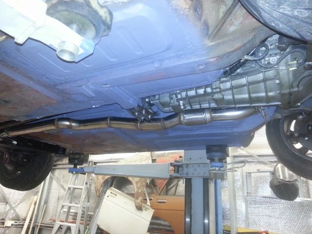

I finished welding up the middle of my exhaust, just need to add a couple of hangers.
ImageGAS1600_056_01 by Garvice, on Flickr

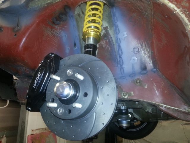

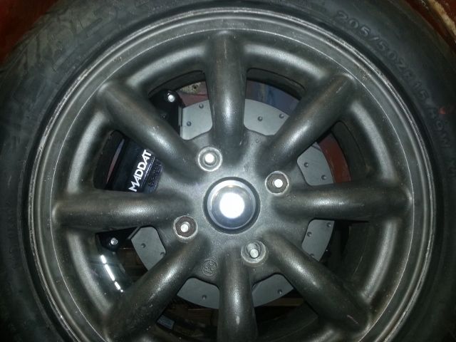

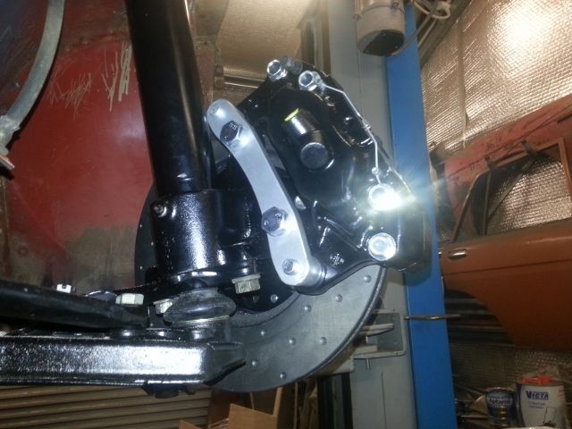

And I also received my front suspension from Maddat. Custom hubs on 200b struts with rx7 calipers and rotors. They fit nicely in a 15" wantanabe.
ImageGAS1600_056_02 by Garvice, on Flickr
ImageGAS1600_056_03 by Garvice, on Flickr

ImageGAS1600_056_05 by Garvice, on Flickr

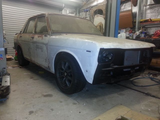

I also mounted my control arms, steering arms, ball joints, steering linkage and steering box.
So now I can say "look ma, no hoist"
ImageGAS1600_056_06 by Garvice, on Flickr
