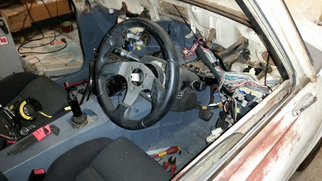

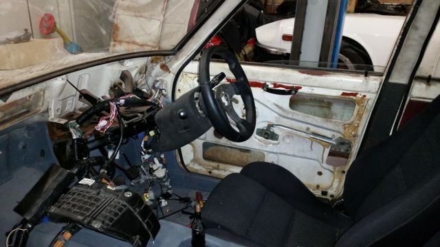

Mounted the Altezza indicator/lights and wiper stalks on the 180b steering column. Couple of small welds on the bracket from the altezza. I'm not convinced about the plastic surround, much bigger than it needs to be, but will be nice to have good quality new switches.
ImageGAS1600_057_01 by Garvice, on Flickr
ImageGAS1600_057_02 by Garvice, on Flickr

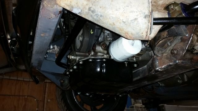

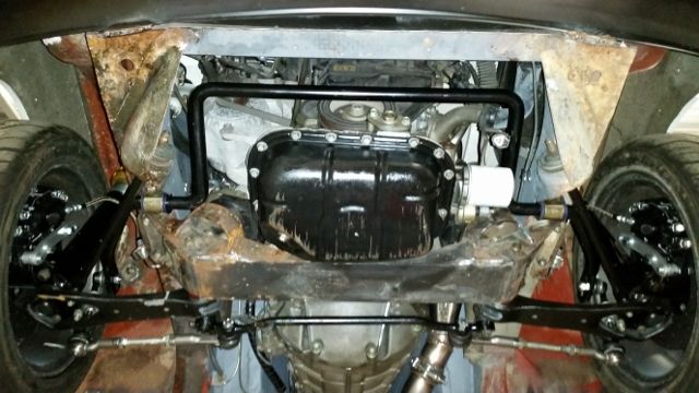

Mounted the Maddat swaybar. Was a pain in the rear (nothing is easy with this engine/car combination). Ended up mounting it upside down to clear the sump. Fouled on the sump and the oil filter the other way.

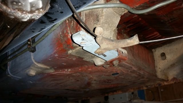

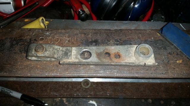

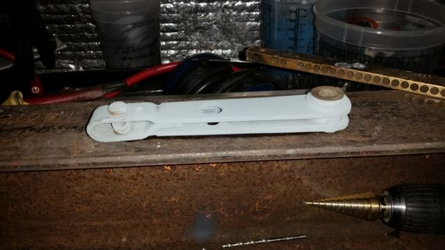

My new exhaust was fouling on the handbrake cables, so i had to lower the saddle a little. Ended up just making a simple modification to the pinion lever so that the saddle sat about 10mm lower. Was enough to give me the clearance needed to the exhaust.
ImageGAS1600_057_05 by Garvice, on Flickr
ImageGAS1600_057_06 by Garvice, on Flickr
ImageGAS1600_057_07 by Garvice, on Flickr

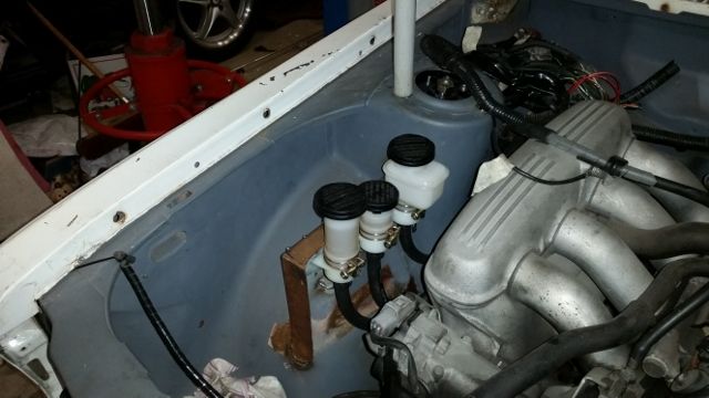

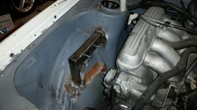

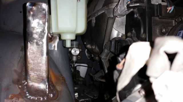

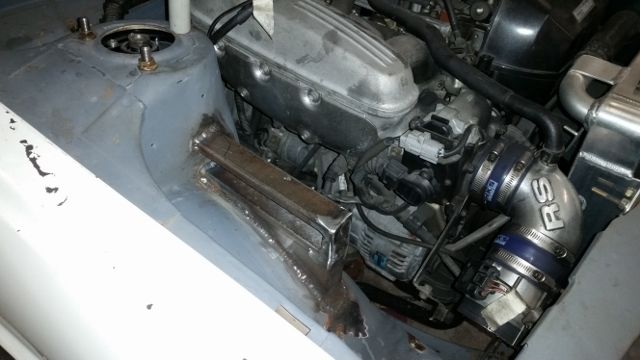

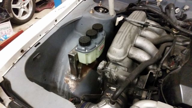

These willwood reservoirs kept leaking (alternating, but mainly the largest one). Might of been something to do with different brand reservoirs or might of been the plastic on plastic connection. Either way I gave up on these which meant I needed to make a new mount.
Out with the old.
ImageGAS1600_058_01 by Garvice, on Flickr
In with the new.
ImageGAS1600_058_02 by Garvice, on Flickr
ImageGAS1600_058_03 by Garvice, on Flickr
ImageGAS1600_058_04 by Garvice, on Flickr
This shows the new reservoirs are still higher than the cylinders
ImageGAS1600_058_05 by Garvice, on Flickr

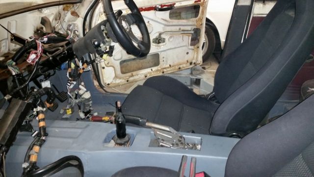

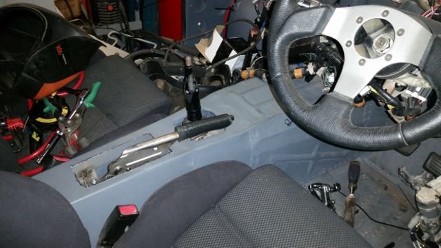

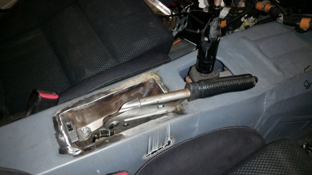

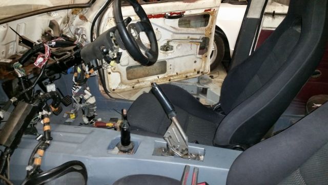

Started on a job on the list, mounting the handbrake. I need to weld the brackets in permanently, make a new cover to seal the tunnel and have a cable made. It is an R33 handbrake.
ImageGAS1600_058_06 by Garvice, on Flickr
ImageGAS1600_058_07 by Garvice, on Flickr
ImageGAS1600_058_08 by Garvice, on Flickr

Sealed up the handbrake mount. Need to get a cable made.
ImageGAS1600_059_01 by Garvice, on Flickr
ImageGAS1600_059_02 by Garvice, on Flickr
ImageGAS1600_059_03 by Garvice, on Flickr

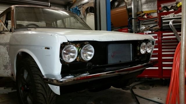

Also got my headlight buckets and bulbs mounted up. Went to wire them up only to find my crimpers can't get around the H4 connector angle plugs. Job for another day now.
ImageGAS1600_059_04 by Garvice, on Flickr

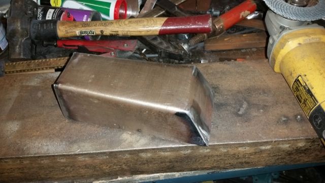

I essentially cut out a large hope the sharp of the indent with 3mm mdf. Then i clamped metal over the mdf and chased the metal into the hole (Stretched it ) with a couple of different tools. Check the link and if you have any questions on the process I'm happy to help.
