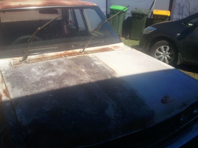

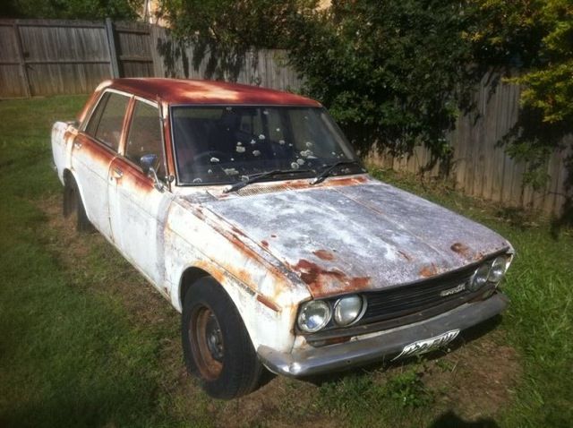

My Z requires more money than I can afford to throw at it, so when my mate told me about this car it just seemed logical.
It cost me a slab of carlton cold and a tow truck to "Come and get it ASAP".
Plans for this car are a quick (like to get it on the road late next year) and cheap build to give me something to enjoy while the Z sits in modification jail.
This is where it got parked in 2003 and it stayed there till I picked it up.
Even had a tree growing through the rear bumper.

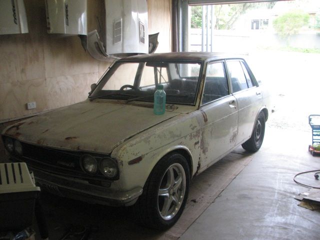

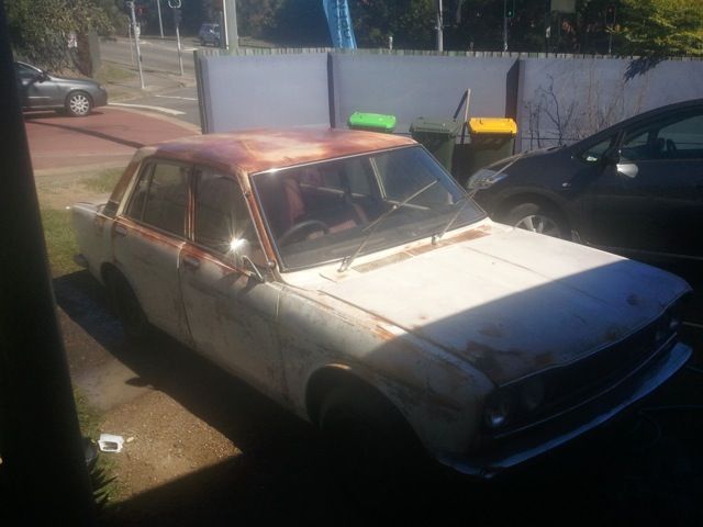

This is after a good wash with help from my eldest.
