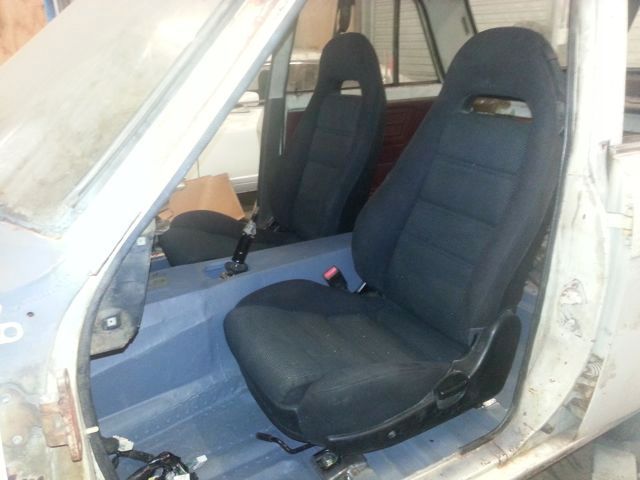

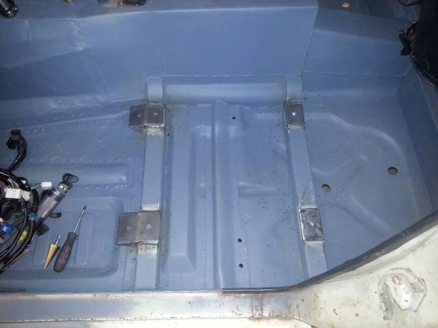

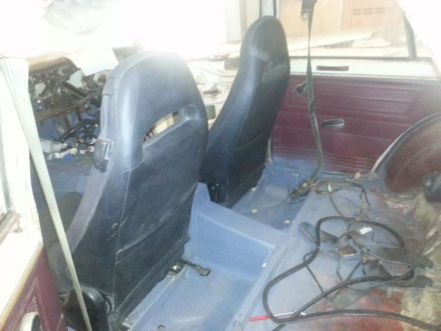

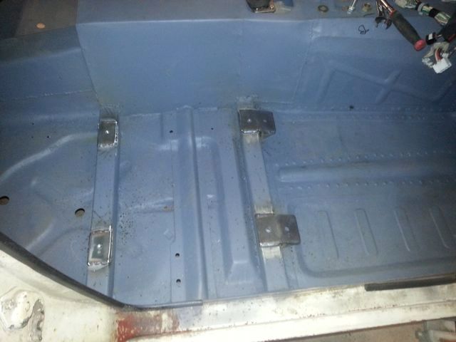

Finally got around to mounting my seats.
ImageGAS1600_050_01 by Garvice, on Flickr
ImageGAS1600_050_02 by Garvice, on Flickr
ImageGAS1600_050_03 by Garvice, on Flickr
ImageGAS1600_050_04 by Garvice, on Flickr
ImageGAS1600_050_05 by Garvice, on Flickr

Post by two_68_510s » 10 Aug 2014 02:53
What kind of seats are those?
Garvice
Posts: 137
Joined: 01 Sep 2012 16:03
Location: Australia
Re: GAS 1600
Post by Garvice » 10 Aug 2014 03:29
Rx7 fd seats (series 6 through 8 ), these are series 8.

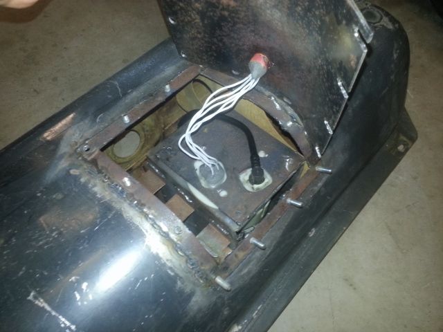

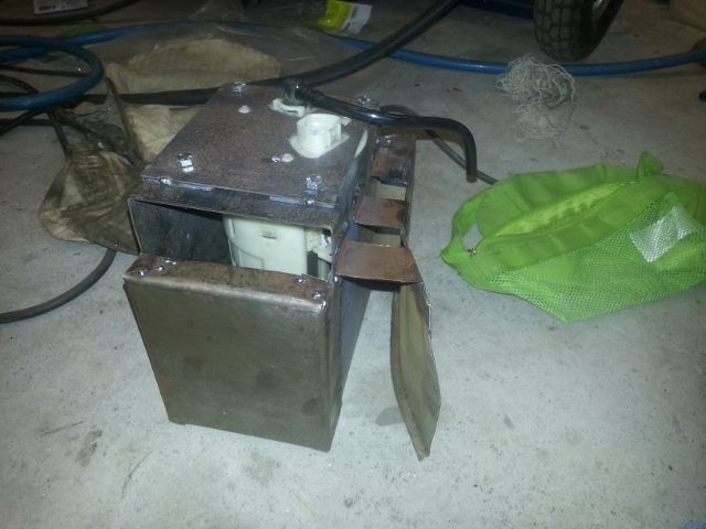

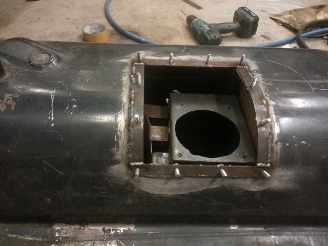

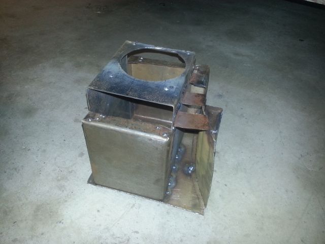

I made a swirl pot for my fuel tank.
ImageGAS1600_051_01 by Garvice, on Flickr
ImageGAS1600_051_02 by Garvice, on Flickr

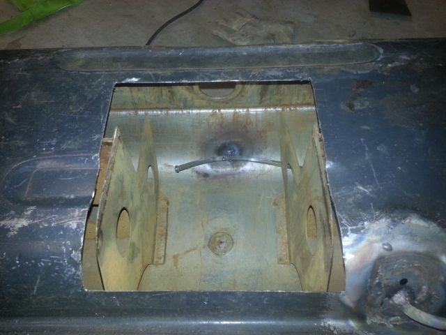

Cut the bottom of the tank open and put a slight sump in, also put a longer internal tube in
ImageGAS1600_051_03 by Garvice, on Flickr
ImageGAS1600_051_04 by Garvice, on Flickr

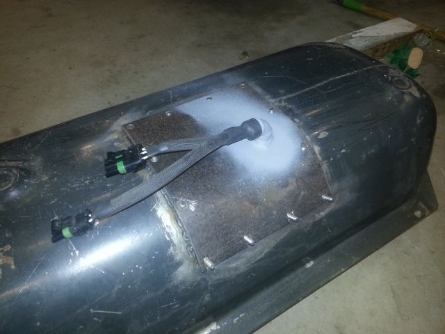

Cut a hole in the top to insert the altezza intank pump
ImageGAS1600_051_05 by Garvice, on Flickr
Potted the wiring
ImageGAS1600_051_06 by Garvice, on Flickr
ImageGAS1600_051_07 by Garvice, on Flickr

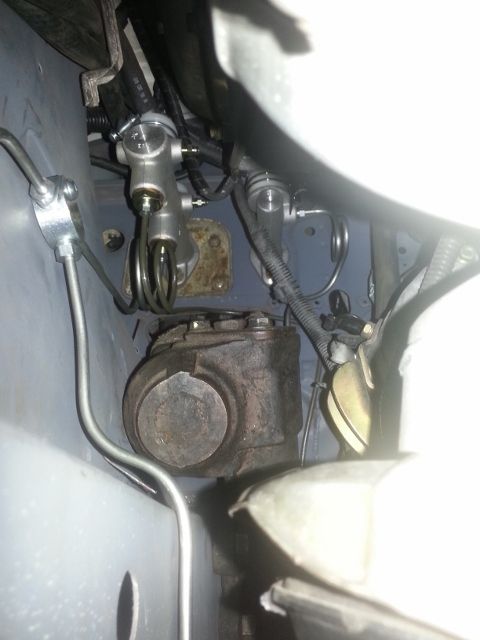

I have also run some brake, clutch and fuel lines. One thing i think I won't do again is try and run brake lines while the engine is still in the car. Hoist made it easier, but it was still a stupid idea. A stripped out engine and driveline would be much easier.
ImageGAS1600_051_08 by Garvice, on Flickr
ImageGAS1600_051_09 by Garvice, on Flickr

Post by Byron510 » 02 Nov 2014 07:26
Great to see some progress.
Yes running the plumbing with the drive train in place would be a pain in the butt.
I'm curious. For the top of your fuel tank, what will you use for a seal in your new access door for the fuel pump?

Post by Garvice » 02 Nov 2014 12:56
Hey Byron,
I'm going to use a fuel resistant sealant. Will be a pain to get on and off (bit like oil pan) but I don't plan on getting in there often so should be ok.

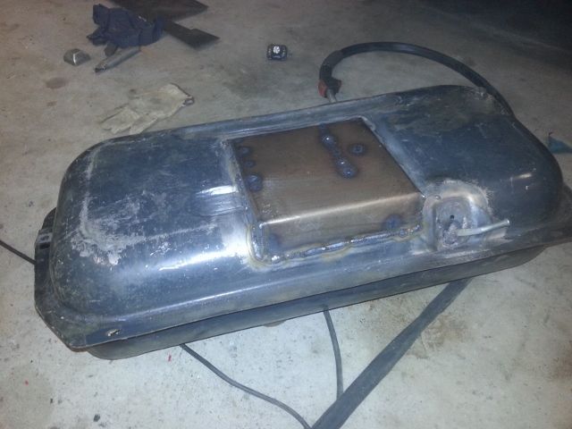

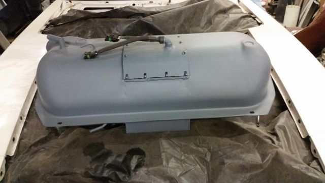

Finished off most of the fuel tank, so gave it a coat of primer. I need to work out a different fuel sender as the arm on the altezza won't work with my swirlpot and I need to find the original sender seal so that i can seal up the tank.
ImageGAS1600_052_03 by Garvice, on Flickr

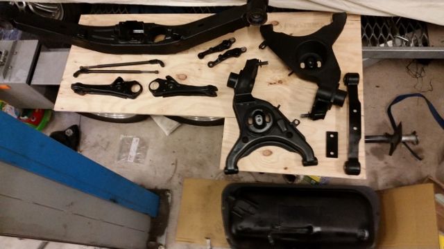

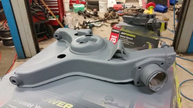

Started cleaning up the suspension components. Blasted and primed.
ImageGAS1600_052_01 by Garvice, on Flickr
ImageGAS1600_052_02 by Garvice, on Flickr
Got to get some chassis black paint to finish these off.

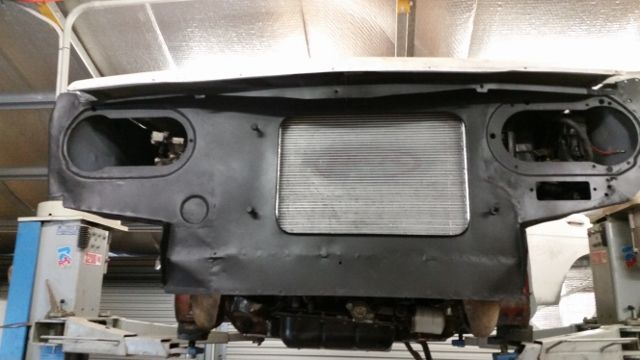

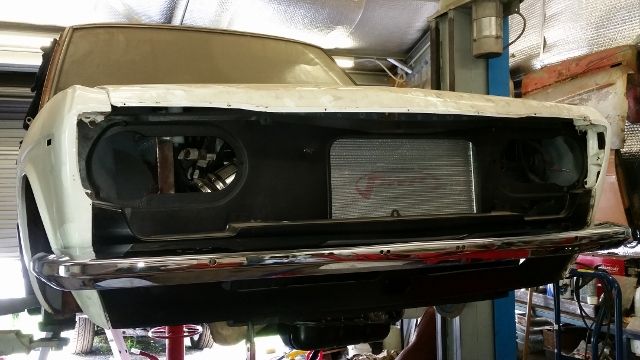

Got some paint on the front of the radiator support.
ImageGAS1600_053_01 by Garvice, on Flickr

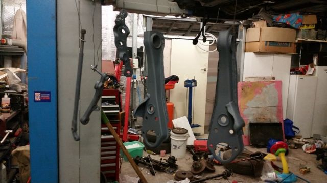

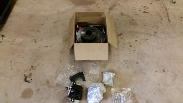

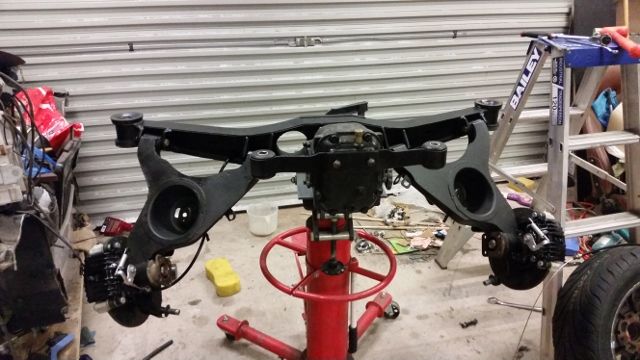

Got the rear brake kit, r31 brakes.
ImageGAS1600_053_03 by Garvice, on Flickr

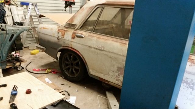

Assembled the rear subframe/brakes etc. Rebuilt the rear control arms with new bearings/seals.
ImageGAS1600_053_04 by Garvice, on Flickr
Bought some semi slicks from Rob at http://tyre-city.com.au/ at Northgate. Massive thanks to Rob, I am recommending him to all that listen. Sent the wife in to get the tires for the stagea and the 1600 and he was extremely accommodating and from my wife (who get sent to a lot of blokey places) "he was a very nice guy, not condescending at all".

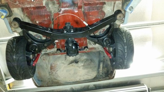

Mounted the rear subframe, got to trial fit the wheels today, they fit on the rear! Woohoo! Need to get some centre caps and new nuts.
ImageGAS1600_053_06 by Garvice, on Flickr
ImageGAS1600_053_07 by Garvice, on Flickr
ImageGAS1600_053_05 by Garvice, on Flickr

Dave at Futofab.com has started making reproduction front bumpers among other panels. I ordered one and it shipped 30/Dec and arrived today 06/Jan! Very happy with the service, will be ordering a rear bumper when they are available.
This photo doesn't have it mounted completely straight (I haven't redrilled the front mounting holes when I rebuilt the front end), but none the less it looks cool!
Very happy with it.
ImageGAS1600_054_01 by Garvice, on Flickr

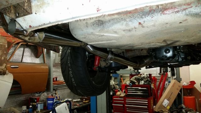

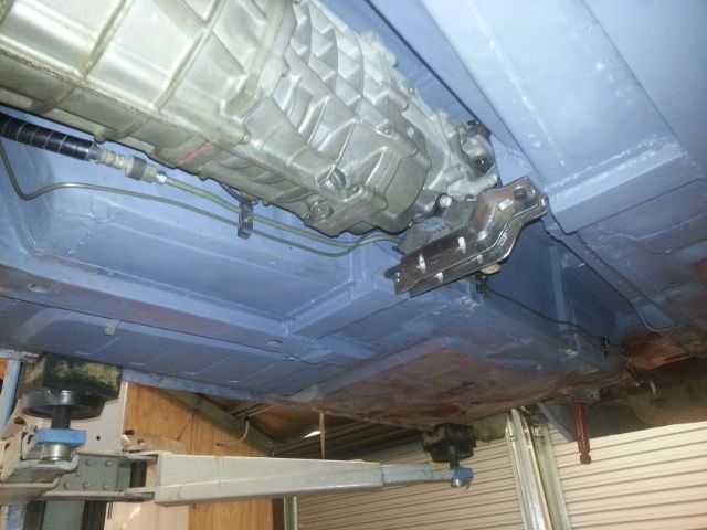

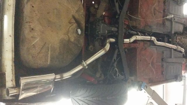

Got a 2.5" heavy wall driveshaft made for the car, so the driveline is now coupled from the engine through to the rear wheels. Woohoo.
I also got a good portion of the exhaust completed. At the worst parts (end of tunnel and the gearbox cross member) it hangs below the sills by about 20mm. The rest of it is above the sills.
It is 2.5" 304ss with vband flanges and straight through oval muffler. I put a flanged section in so that the rear crossmember and components can be dropped by just removing a short section of pipe. I have to put some hanger supports in for the middle section of pipe and weld up the joins in the middle section (middle section is only tacked). I am also going to put a 2.5" bend on the muffler outlet to point the outlet slightly down and away from the stock exhaust relief.
Three things that i've learnt along the way doing the exhaust.
1 - The 1600 tunnel is stupidly small. It is like they were designing a front wheel drive car and at the last minute decided to make it rear wheel drive. I don't know how people fit 3" exhausts down that tunnel. I have a small drive shaft and a relatively small exhaust and it is less than ideal.
2 - The 1600 spare wheel well is enourmous. It has to be one of the biggest wheel wells in history (tongue in cheek). It makes it hard to fit any decent sized muffler at the back.
3 - Exhaust work blows. I can understand why people pay to get exhausts done, not a very fun job.
ImageGAS1600_055_01 by Garvice, on Flickr

Post by KiKiIchiBan » 01 Feb 2015 04:18
Exhaust looks good, any chance of better close up pictures to show clearance?
I plan to run mine in the tunnel as my car is very low and then poke it out the side.

Post by two_68_510s » 01 Feb 2015 06:46
Man, if that is how you do shit you don't like, your regular work must be fabtastic!! It looks beautiful!
