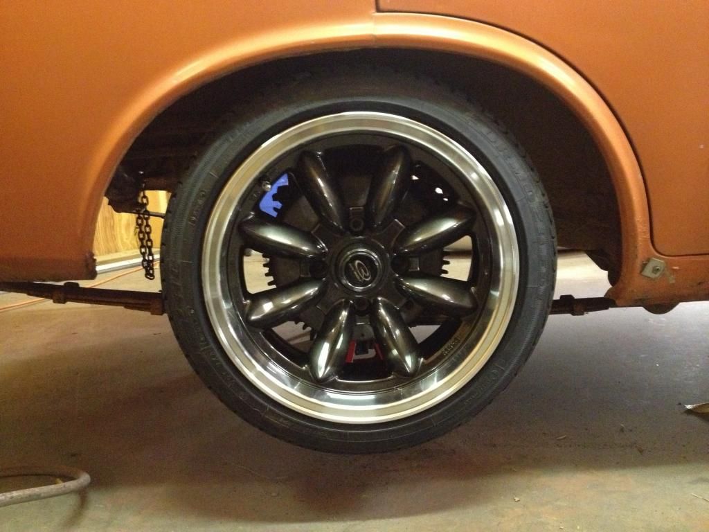

My old wagon with 2" drop in the rear (no spare, empty cargo area, unknown gas volume) and 195/50/15s:

... . . last night i returned to the Datsun Garage and did some filling on the wagon's engine bay.
and as we were waiting for the filler to dry, we figured out why the wagon was sitting so high. Problem: the wagon was basically sitting on the bump stops. Turns out, all we had to do was grab a couple of beers, sit in some chairs and stare at the wagon and BAM come the answers.
We used the band saw to customize the bump stops.
I used the zawzaw to cut the excess threads off of the u-bolts.
This is a photo of how it sits with jack stands under the axles and with blueridgespeed sitting in the back hatch compartment. Travel looks good and no issues so far however, I still need to order some lug nuts and see how it sits on the ground (hence the reason it's in the air). The wheels look small with the stretched 50's but I think it's going to help us get to the height we want.
and here's a close up.

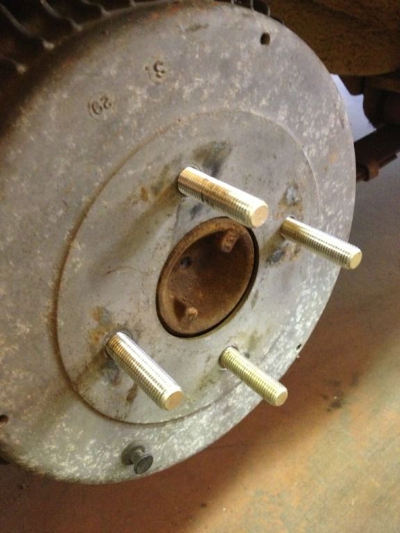

Blueridge hooked up some new, longer, stronger, lugs and we were able to add spacers and get my rim pretty flush to the lip.
