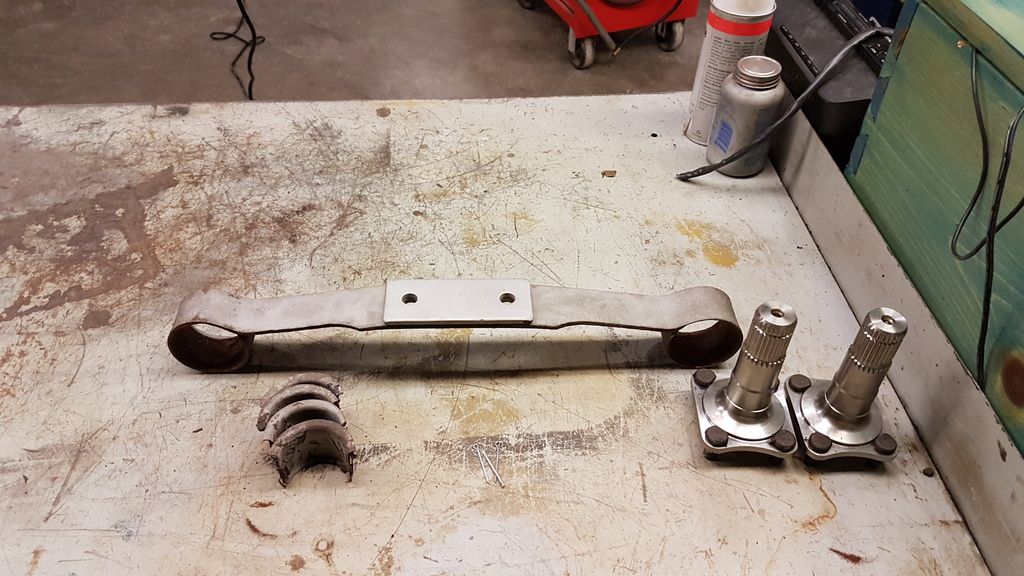

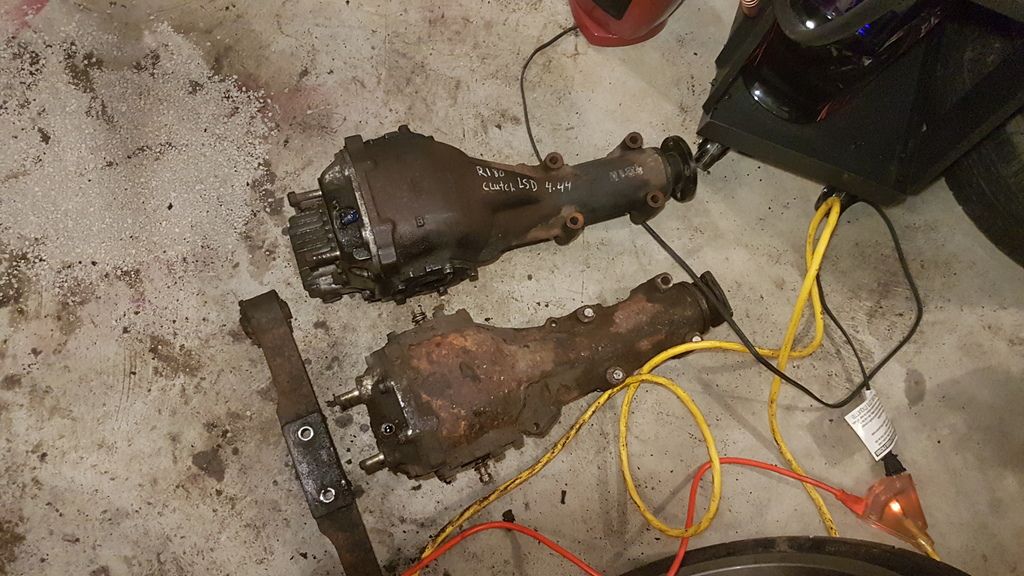

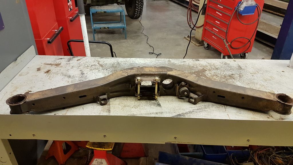

Brought my crossmember with me to work today and spent the day cleaning it up and pressing the old bearings out. Only a handful of us there since it's March break so able to work my own stuff. Might get the crossmember sandblasted by a co worker if there's time tomorrow. When i got home went to work on the diffs, took the old r160 stubs out, pressed the axle studs out of them and went to change the driveshaft flange but my cheap impact wouldn't budge the nut... Guess that's coming with me to work tomorrow as well haha.
Crossmember all cleaned up and waiting on primer/paint
The old crusty r160 next to the slightly newer, slightly less crusty R180. It'll be getting cleaned up and painted too

Didn't bring my diffs with me to work since I didn't want diff oil all over the back of my car, going to sign out one of the heavy duty impacts and bring it home Monday to get the input flanges off. Was able to get the mustache bar bushings pressed out and then sandblasted and pressed my axle studs into the stub axles. I order my set through T3 and there was no way those studs were going in with anything other than a hydraulic press, VERY tight fit.

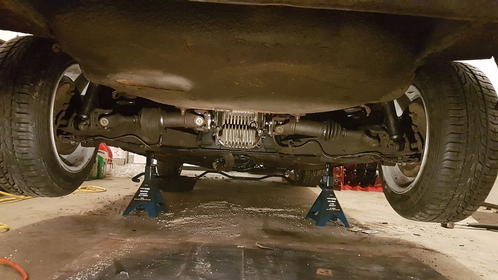

Everything is all back together for the moment with a few small things left to do, just bleed the brakes, fill the diff, and reconnect the exhaust

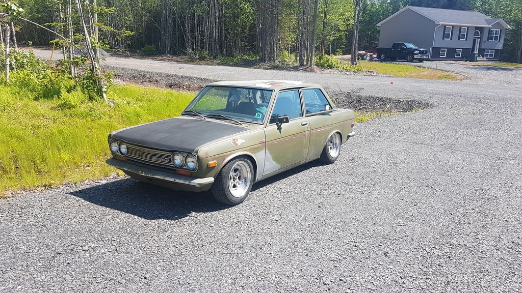

finally back and did some small things to the 510, threw the t3 rear coilovers on and currently dialling them in. Went for a good long drive and had them settle a little in this pic, need to raise them back up slightly now

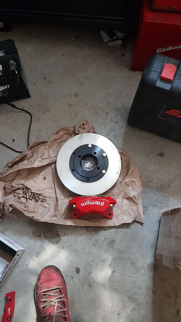

Next on the list is to throw the wilwoods on, this is my first set of real brakes, quite the difference just visually

Finally got the Wilwoods on and took the car for a drive with a buddy, feels good to actually drive it again!

Did the Wilwood setup come from T3 as well, or did you DIY a bracket/rotor swap?

okayfine wrote:Did the Wilwood setup come from T3 as well, or did you DIY a bracket/rotor swap?
They came from Don at DP Racing, can't say anything but good things about the products and Don himself, real easy guy to get along with.
