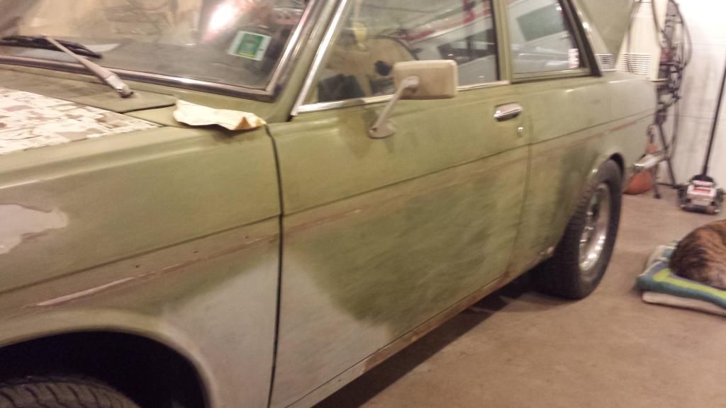

Haven't updated this for a bit as I've been pretty busy with work. I'm in the process of swapping the webers onto the engine and tuning them, welding up my return spring for the clutch pedal, looking at starting to install my LSD rear end, and have finally started sanding the car in prep for paint!
After a little bit of sanding it doesn't look all that different from my faded paint haha
Also a good buddy offered to sell me his 74 260z which I'm really thinking about. Needs floors and brakes but has a good running engine and for $800 can't go too wrong. Only thing is it might be a 2+2 model which I'm not crazy about. Will wait and see what happens there!
