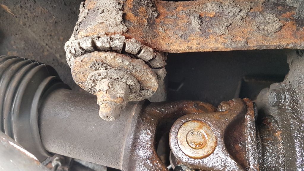

Next order of business isn't as cool as bigger brakes or rear coils but it needs to be done all the same. Crossmember and mustache bar bushings are totally shot so ordered a set of both from Whiteline, while I have everything off might as well do the rear control arms so have a set from Energy on the way too. Going to clean up and paint everything while im at it and probably get the exhaust hole enlarged so I'm not rattling my 2 1/4" exhaust against it while idling.
Poor things :(

Def looks like time for new bushings. On the rear a-arm bushings, is your crossmember slotted, or otherwise adjustable? Most versions of adjustable crossmembers won't work with poly a-arm bushings. They'll bind, adding tons of spring rate.
Also looks like you might benefit from a CV axle setup, given the angularity of your half shaft. Any vibrations at speed (buzzy rear view mirror)?

Don't make my mistake and do poly on the rear control arms. Put them in the crossmember and mustache bar but NOT in the controls arms. Just put new OEM ones in and you'll be very happy.

okayfine wrote:Def looks like time for new bushings. On the rear a-arm bushings, is your crossmember slotted, or otherwise adjustable? Most versions of adjustable crossmembers won't work with poly a-arm bushings. They'll bind, adding tons of spring rate.
Welcome back!
Thanks!
Mine aren't adjustable so hopefully will be fine. And surprisingly don't have any vibrations, a CV kit is definitely something I'd like to pick up in the future though.

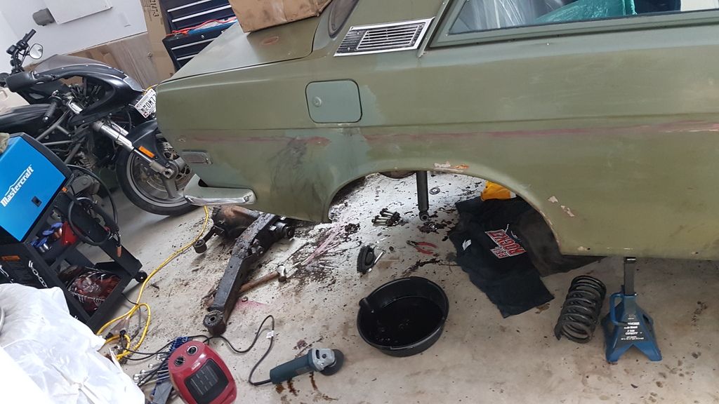

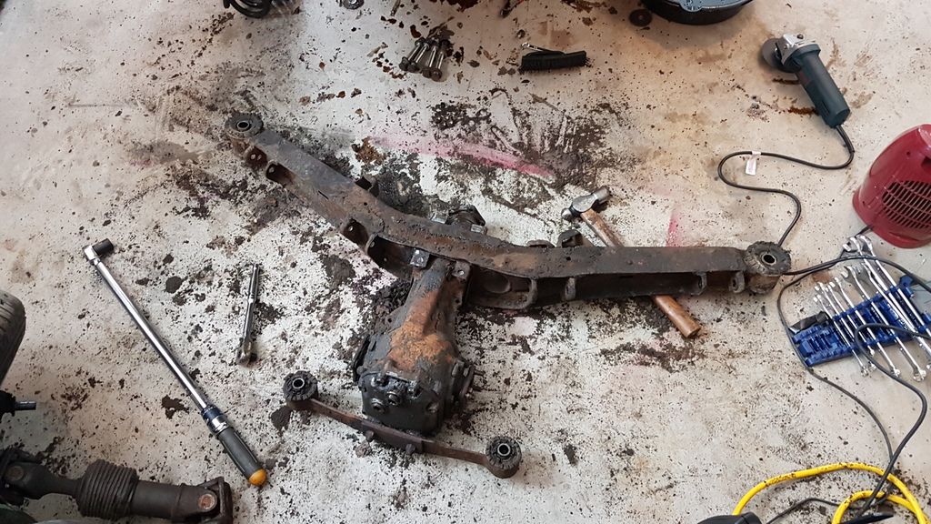

Post by Canadian510 » 04 Mar 2017 19:23
Got a good chunk of work done today! Crossmember is out, control arms are off, and diff is out!
Was expecting everything to put up much more of a fight, only issues I ran into were some seized bolts holding the diff in but with enough persuasion and heat was able to pound them out or grind them flush.
Tomorrow I'll work at removing the mustache bar from the diff, fitting the stub axles into the r180, and hitting the crossmember with a wire wheel to clean it up. Hopefully find someone local to enlarge the exhaust hole too.

Do you need to add any adjustablity with the camber and toe? Now is the best time for it.
I don't mean to hit you with a sales kick, but I can help you out there if you were thinking about it. You have it all apart, seems like as good a time as any.
