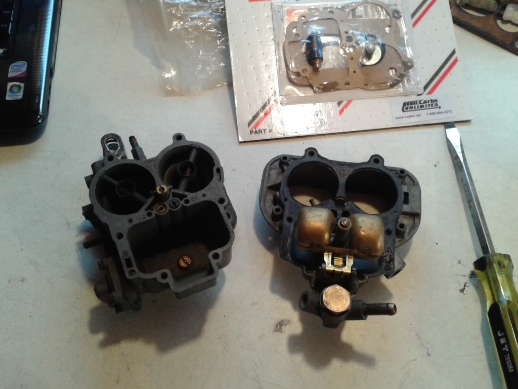

Pulled the carb apart and "rebuilt" it using the redline kit. Gave everything a real good clean using seafoam and a scotch pad then used air, made sure all the jets weren't clogged.
The guts all pulled apart. I used this from a supra forum as a general guide line http://www.mk3supra.org/topic/561-guide ... dgav-carb/
Clean, reassembled and reinstalled
And.... IT RUNS! A vid after it had warmed up
http://s1318.photobucket.com/user/matty ... 0.mp4.html
I tried tuning it a little bit but as you can see it still hesitates if you give it quick throttle, I'm not sure why this is? And it was leaking where I pointed the camera but it stopped.

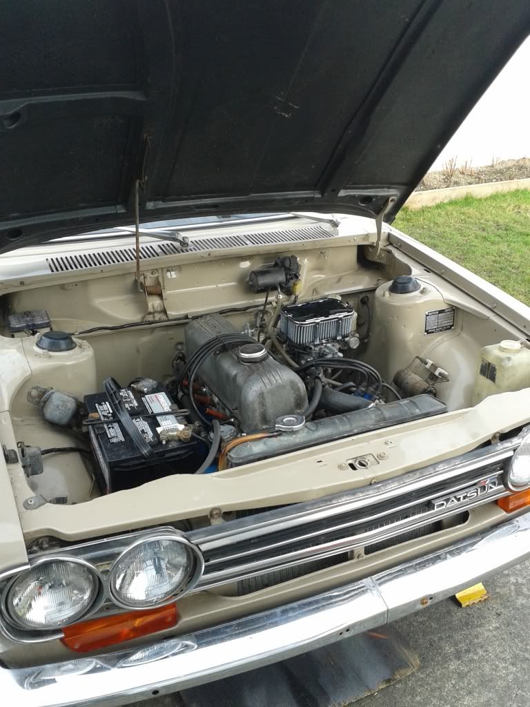

The car runs much better now that the accel. pump diaphragm is in the right way
Air cleaner on

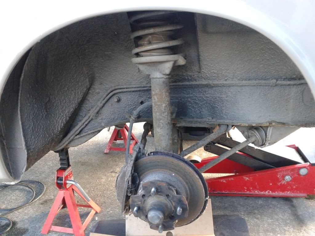

I got the 200sx struts in
Out with the old!
And in with the new(er)
No callipers on of course, wish I could run no cap steelies :cry: New calipers are on their way

Posts: 454
Re: 1970 4dr 510
Postby RONSLYCHUK » 27 Jan 2014 20:21
Congratulations. Nice find. It looks like you are off to a good start.I am sure you will find all the info you need here. Keep the pictures coming! Ron.
Posts: 3688
Re: 1970 4dr 510
Postby two_68_510s » 27 Jan 2014 21:02
You have already transformed that car, looks great man.
Engine compartment looks really good.
