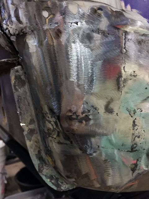

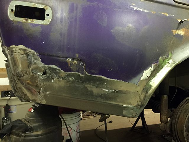

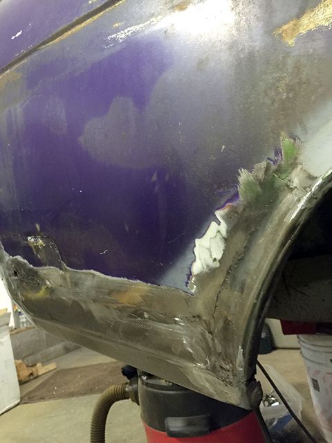

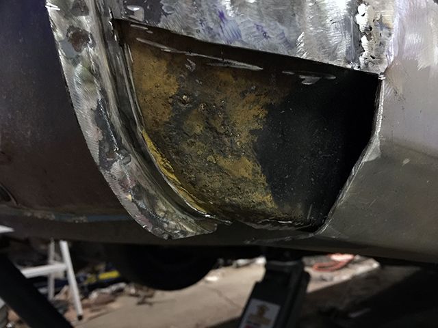

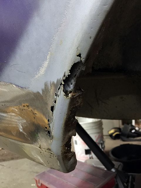

I cut out another hunk of the quarter and made new panels. They're coming along pretty well & it feels like progress! Yay!
Tomorrow, hopefully I'll get that corner piece welded in.

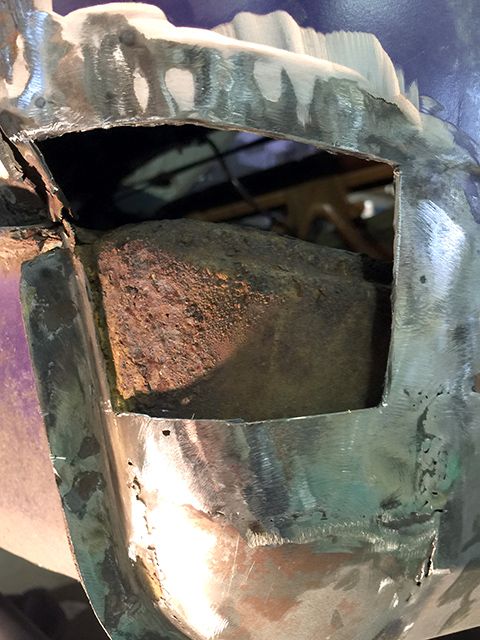

Here's today's progress:
Starting the forming of the repair.
Once I get that welded in, I believe that's the last of the welding needed on the passenger side.

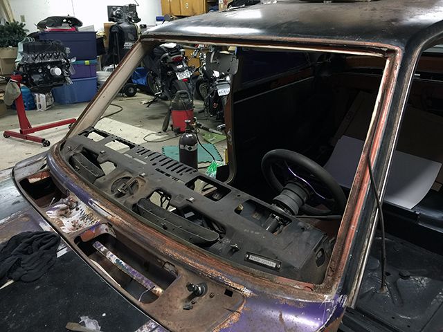

I also got the windshield out. I was shocked that it wasn't all rotted under there.

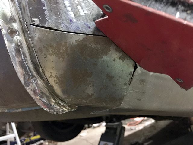

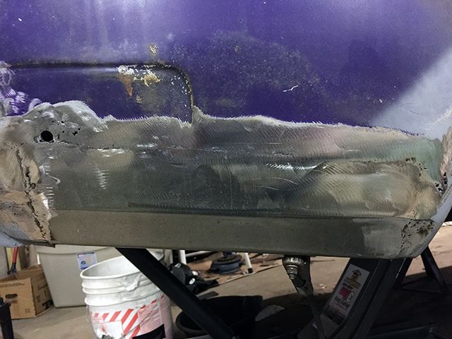

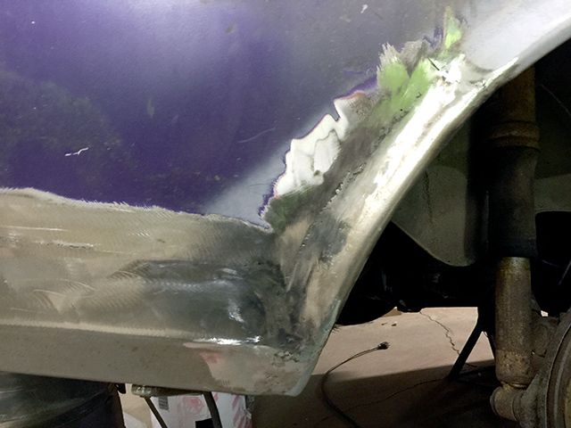

I finished the wheel well patch. Here is the quarter panel patch all welded in.
It'll feel good to move to a different section of the car. :)

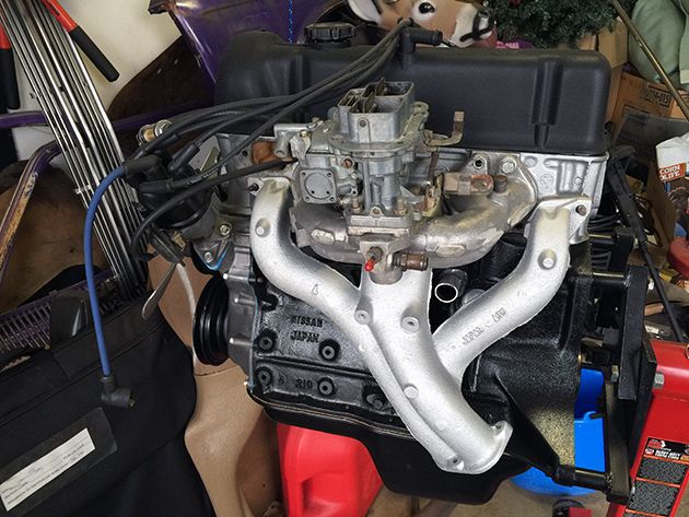

Yesterday, I took the valance off. That thing was pretty mangled, but I got it straightened out and it looks good again. Also, my new-to-me exhaust manifold came, so the engine is finished. Yay!

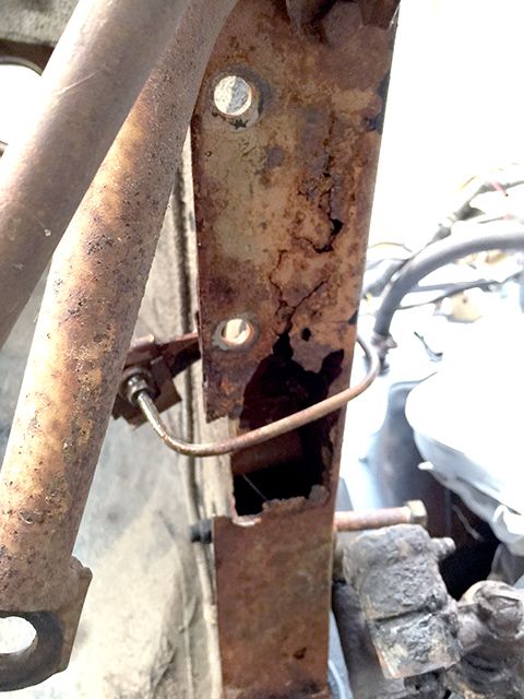

Today, I took off the right front wheel. That was a real treat since the lug nut didn't stick out far enough to get a 4 way on and it was seized inside the rim. It took me a couple hours to get it off there, but once I got that off, the rest of the hardware I needed to remove to take out the cross member came out pretty easily. I was shocked! Well, it went well until it came to getting the tie rod end apart. That took me a long time, but I got it.

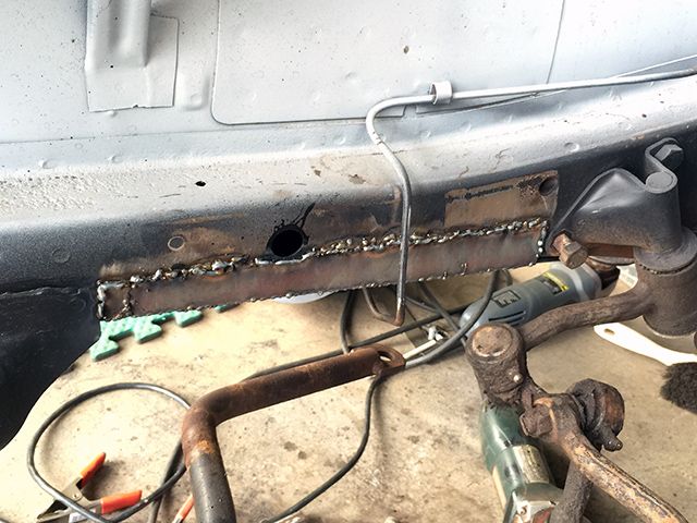

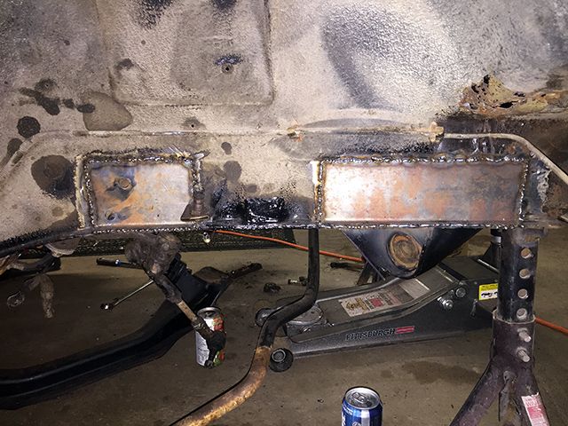

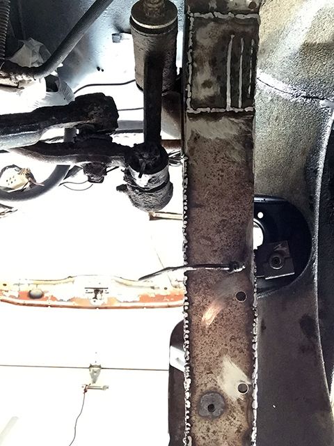

I found that I have a huge problem. My "frame" is really rusty on the passenger side under the battery, pretty far back. I plan on repairing it with thicker steel, but I'm afraid of doing this repair since it's structural. At this point, I don't have a choice and it's all me, so I guess I need to do some research on the best way to attack this.
Repair method suggestions welcomed.

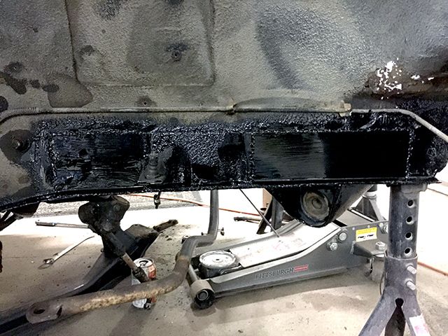

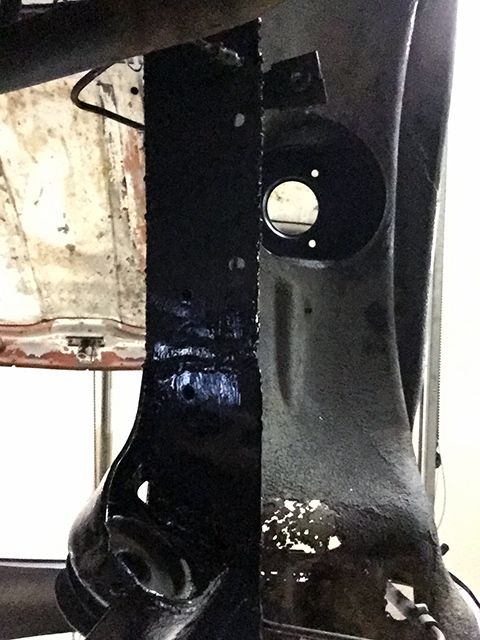

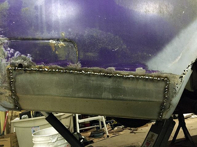

Well, right, wrong or otherwise, I jumped in with both feet. The frame repair is coming along. I used 16ga steel to do the repair and as always, I coated every last bit of metal that I could reach inside with POR15 and the repair patches themselves. I welded the sway bar mounting nuts inside before putting the patch in, too.
Tomorrow, I'm hoping to have the rest patched in and I can move on to removing the battery tray and fixing the inner wheel well.
This will be tidied up.
2DoorJim
Posts: 272
Joined: 15 Jun 2013 21:43
Location: Calgary
Re: 72 2 Door 510 Restoration-25 years in the making
Post by 2DoorJim » 16 May 2015 22:06
Looks good.
I don't think the frame rails are any heavier than 16gauge so you are on track - using equal or heavier ga. for replacement.
I used 1/8" plate up front to replace the area where the bumper brackets mount, bit tougher in this region is not a bad idea.
Posts: 160
Post by Rush » 17 May 2015 21:00
Thanks. It looked about right when I compared them, so I hope this solves the problem. I don't think the car was safe to drive the way it was, that's for sure. Kind of an unpleasant surprise.
I didn't get a whole lot done today since hubby was home from his work trip, but I managed to get a couple patches made and welded in. Tomorrow, I hope to finish this area and move on to the next.
I plan on putting fresh rubberized undercoating under the car when the time comes, so I think these repairs will blend in nicely (or not stick out like a sore thumb at least).

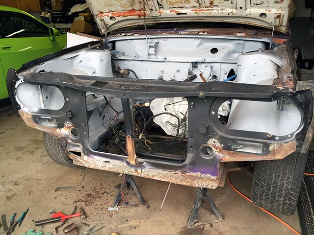

I feel like I'm making progress overall, but going over an entire car inch by inch seems like it'll take forever. I'm beginning to wonder if I'll even see it run by the end of summer. I think I need to concentrate on getting the engine bay finished so I can drop the engine in and free up some garage space.

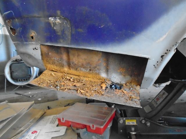

And, now for something really different...rust removal! :lol:

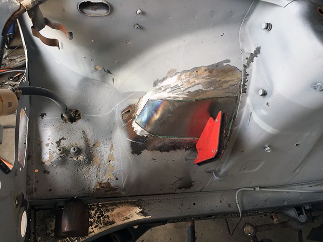

I started on the battery tray delete and inner fender-well rust repair today. I finished the tray delete, but I'm still working on the rust repair that was below it.
So far, so good.
