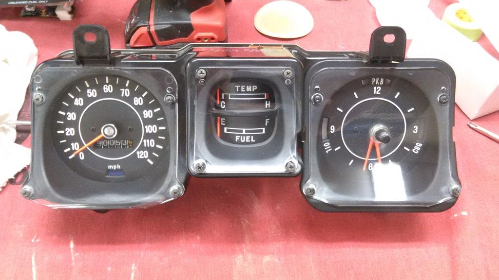

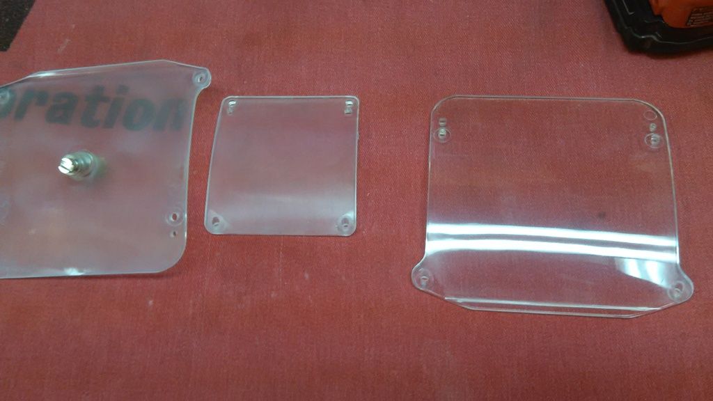

So I am in the process of getting my speedo working I disassembled the instrument cluster to see if the S-13 speedo will work, in the process I decided to restore the gage lenses. This is ultimately what I would like. As you can see the S-13 gage is larger than the tunnel/housing and some of the increments are covered.
I am using a headlight restoration kit from 3M. The lenses on the right has yet to be prepared, ones on the left have had the first stage of sanding done. The kit has 500, 800, 3000 grit and a polishing compound that you put on a sponge and finally a wax to protect the lense. as the lense was not in too bad shape I decided to start with the 800 grit then used the 3000 and polishing compound and wax

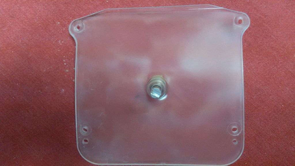

Close up view of lense after the 800... this is a little nerve racking as you are putting scratches in the lense and at this point in the process looks like it is ruined!

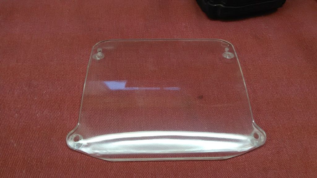

Here is a close up of the lense after using the polishing compound.
Now this one has had the final step which was to use the provided wax in the kit.
Here is the completed and assembled gage cluster, it is hard to get a pic of it without the glare of my overhead lights.
