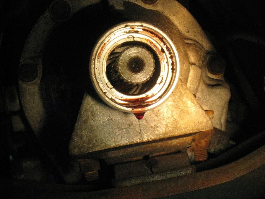

I was hoping one of you guys could help me figure out an Automatic Transmission issue.
I'm in the middle of working on the rear end and I pulled out the drive shaft about a week ago. Today, the transmission decided it was going to spew fluid from the rear, with seal still in place. When I pulled the drive shaft I didn't have any leaks or issues.
Thoughts?

did you change the position/height of the jackstands at all after you pulled the ds? i.e. did you raise the front higher than the rear for some reason? That would do it

voodoo?
was it a slow drip for a week? (doesn't look like a lot if that)
or all in one day a week later?

Doesn't the driveshaft complete the seal just like a manual transmission??

Hm, I didn't notice the leak until a week later, but if could have definitely been a slow leak. I definitely didn't make any changes to the jack stand heights. It's been sitting in the same position for a while now.
Does the driveshaft complete the seal like McShagger510 suggests? I suppose that would make sense. It could also be that the car, even though I haven't changed jack stand heights, is on a bit of an incline. The carport does slant to the side a few degrees.

Been hot recently? Expanded fluid, etc. Trans output shaft seal isn't sealing anything at the current time, since you can see between the seal and the output shaft. Any trans that has the DS pulled should have a plug put in place. We tend to collect them as we go through different transmissions, etc. I know I have at least three on the shelf.
No harm done, other than the mess. But auto trans fluid is mostly detergent, so it's cleaning your driveway. Feature, not bug!

In my experience the fluid is usually pretty viscous so you can remove the driveshaft and not notice a problem but the oil flows (albeit slowly) out of the trans and coats the floor overnight. Nice surprise when you get under the car the next day or whenever :(

Thanks for the input guys, this definitely puts my mind at ease. I definitely didn't want to jack around with and put much money into the Automatic Transmission (besides filter and fluid changes).
