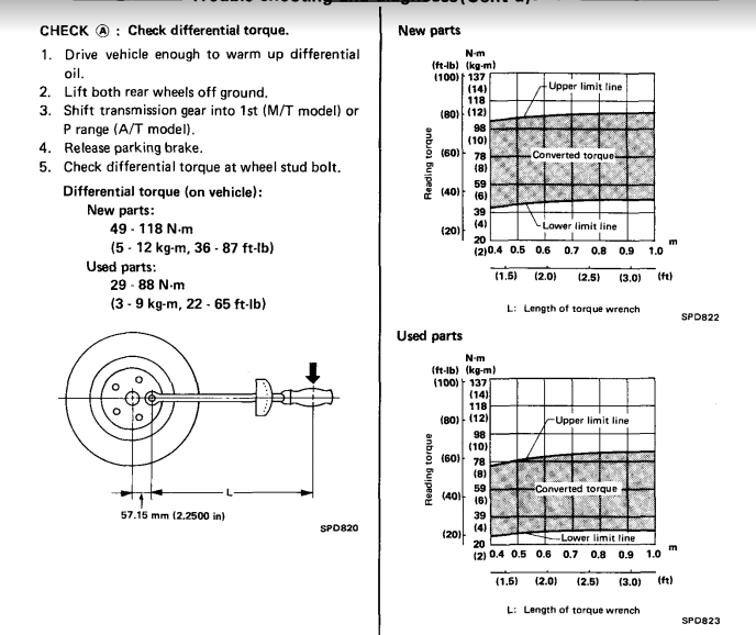

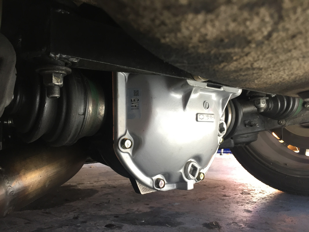

It's installed and broken in. I haven't taken it out yet since I changed the fluid, but my initial impressions are it's noisy and clunky. I assume it just needs to break in more, but I'm sure I have some bushings that need some refreshing.
I still don't have a proper torque reading. I followed the Factory Nissan manual for checking the torque at the wheel, but it just says if it's within spec or not. I got a reading of about 60ft/lbs before break in, and about 50ft/lbs after using a torque wrench with about a 16" handle.. According to the manual, that's within spec, but I have no idea what the actual reading is. I'm sure there is a math equation that I can calculate it, but I don't know it off hand. Anyone have input?

Post by JordanTr » 19 Jan 2019 16:28
Are you using a bending beam or click type torque wrench?
Need a bending beam to really do this accurately.
I can help you work through the force/moment balance later.

Post by Byron510 » 21 Jan 2019 23:46
Just as a passing note; when I installed my new Precision gear CLSD years ago- it sounded like a bag of hammers Out of the box. I seriously thought it was broken. After putting a few miles on it, and adding a bottle of GM LSD fluid, I found a parking lot that I could drive around in tight to tighter circles both turning right, then turning left for 5 minutes at at time until I thought I was so dizzy that I was going to puke....
But it did get the fluid between the clutch plates and the diff sounded and worked much better from that point onwards.
You’ll find that once the fluid is between the plates, your break away torque will call a bit. So at roughly 50lbs - your close. I wouldn’t want to drive it much night unless you’re on R compounds or race rubber.

The unit seems much better the more I drive it, and it really only makes noise or clunks during low speed tight turns while on throttle. At higher speeds and gentler turns, it doesn't make a sound. I still have no trouble breaking tracking through second gear, but it seems more in control based on the little hooning I've done so far. I hope to put a few more miles on it before the road course event this weekend. Now if I can only sort out the brakes so I don't die.
