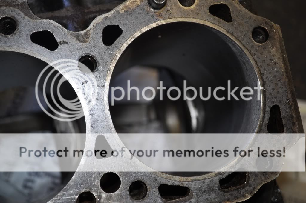

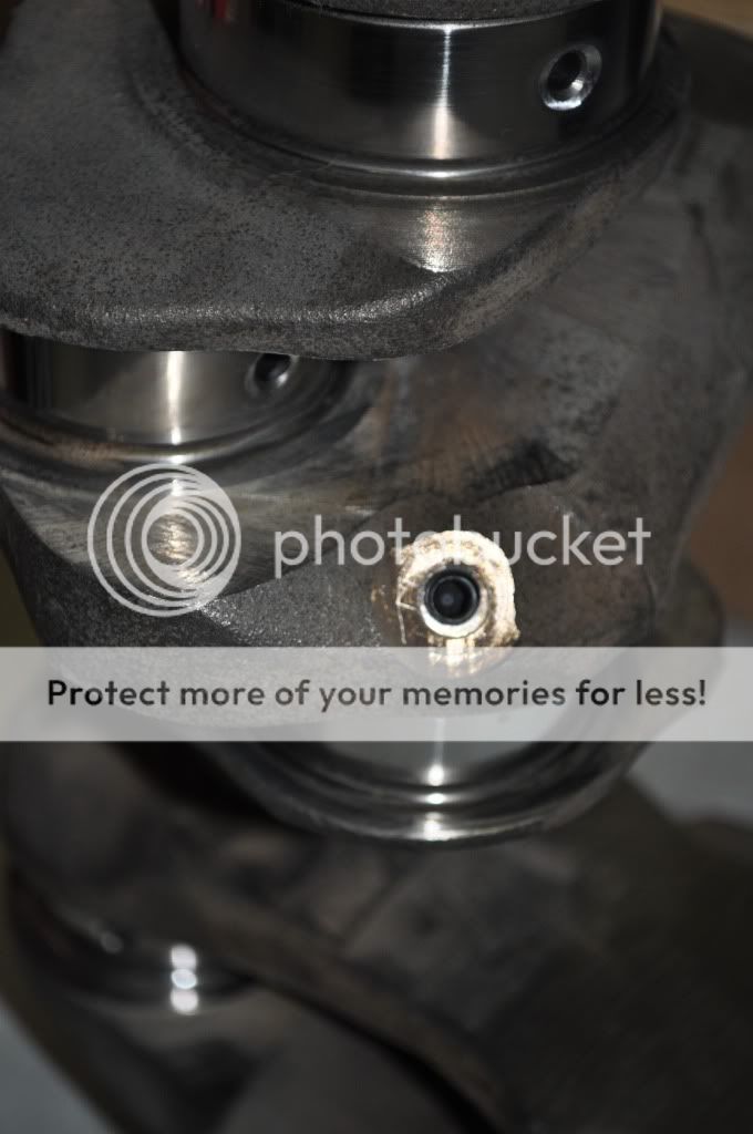

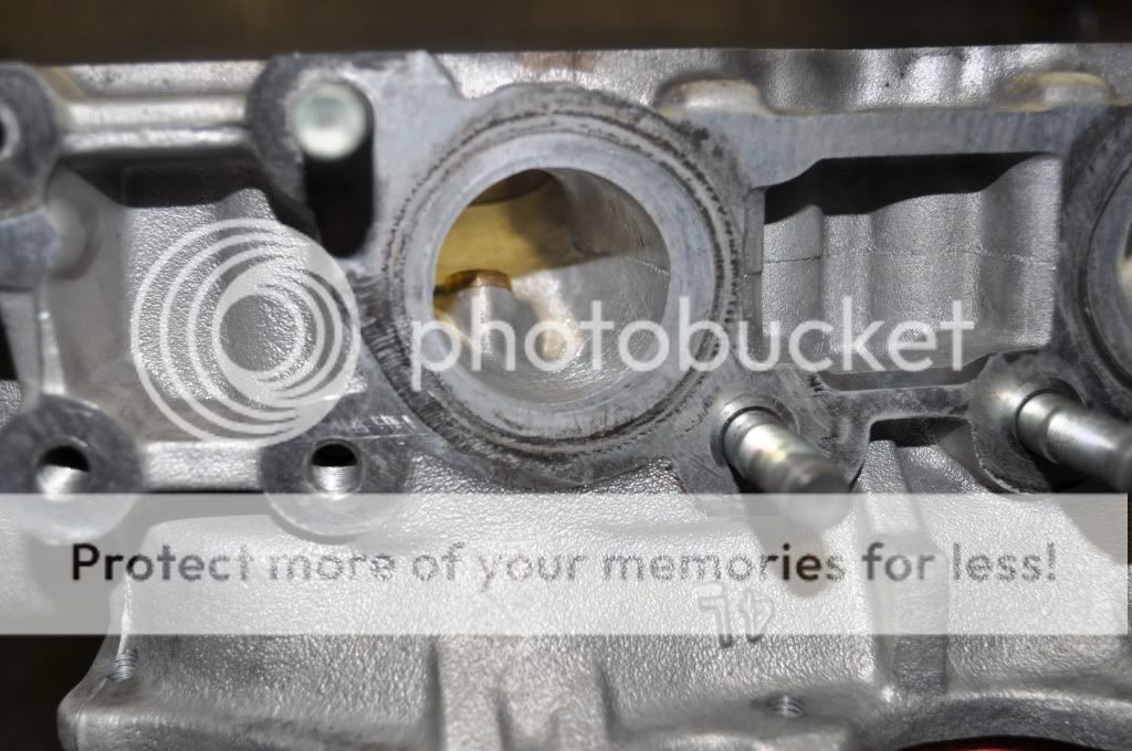

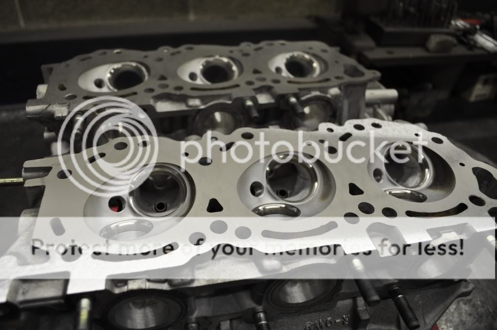

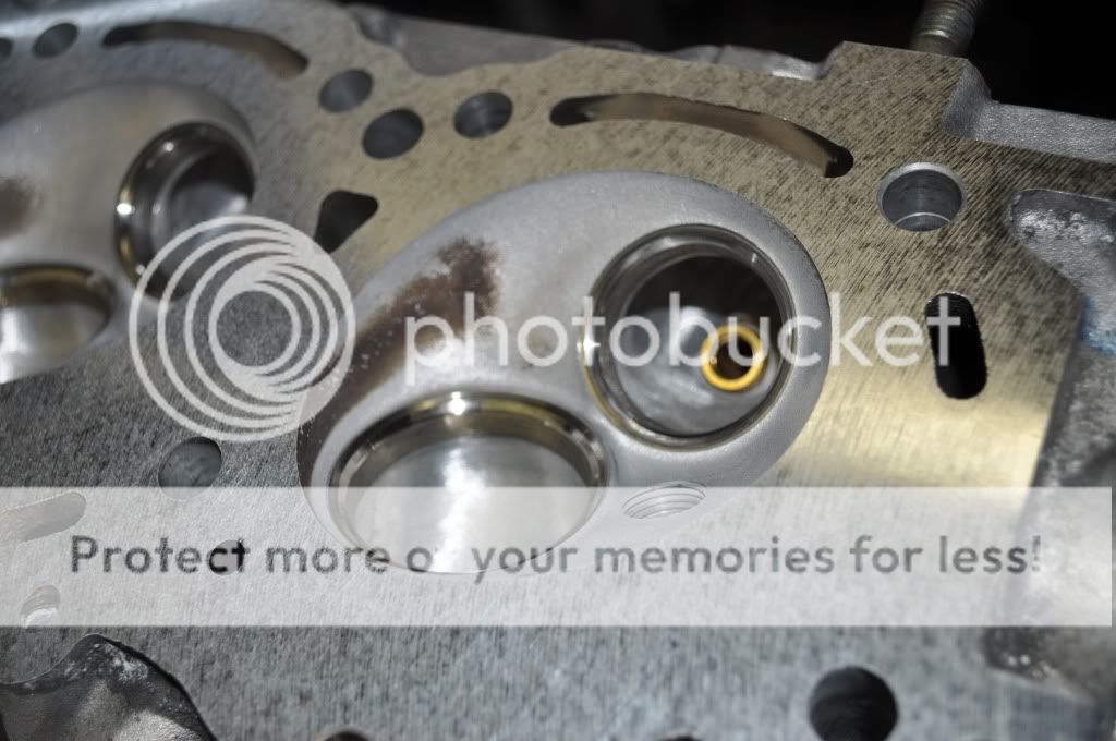

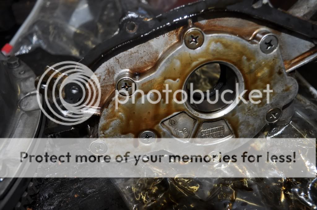

Ok guys, I have been a bit distracted by a few personal things, and some other projects. Here is the update:
Stock VG33 from Pathfinder block is in great shape. Machining required for the Infiniti Pistons is .060 Over. Clark took out the all of the oil galley plugs, cleaned up a lot of the flash casting areas that were an easy kill. Also took out the oil plugs out the crank. Crank checked out, and is all polished up and ready for balancing. Heads needed reconditioning. It did some great port work on the heads. The valve job look jewelery quality.
We had a few interesting conversations. I brought over my new vG30ET oil pump. Much of the discussion about this oil pump I have found states that it does run a high pressure. Most think that this is from just a different spring. He took the pump apart, polished the gears and looked at the differences. The external castings look to be identical. Internally they are not. the pump is self is actually wider. Stock pump internal (off a 200sx VG30e) measured about 1.000, new VG30et pump internals measured about 1.150 thick. this can be also measured on the inside of the shaft drive on the pump.
We are going to build the short block and check the clearances from the valves to the pistons. We think that the piston will clear the timing of the valves 100% without any machining at all. Most all of the builds I have read about that are vg34e's start out as vg33 (I guess thats a given). All of those motors are non interference. I think that everyone was just looking to keep them non interference.
We will find out for sure. But you can almost deduce that when you closely compare the vg30e, vg33e, and vh45de pistons to eachother.
Not having to cut valve reliefs saves money, saves time, and nets higher compression. We may be wrong, but we will soon figure this out.
Here are some pics from today:
The old VG30e oil pump:
The new VG30et oil pump:
Reconditioned Heads/port work (stock VG33e heads):
Block Machining Overbore .060 to accomodate vh45de pistons (VG33e pathfinder block).
Polishing of the Crank (my original VG30e crank):
VG30de rods are in fact a perfect fit for the VG30e crank, and the VH45de piston wrist pins.
