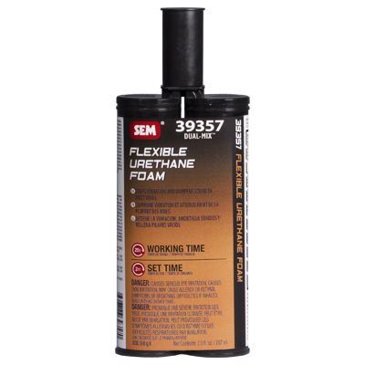

What would one use on the body seam that goes from each rear window lower corner to the trunk corners?

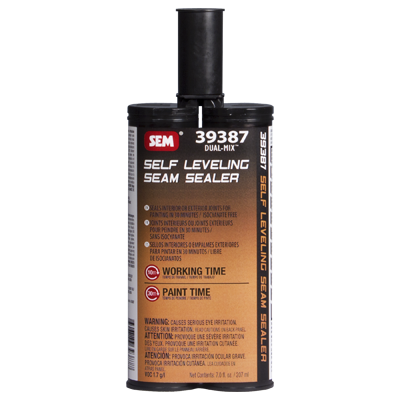

What about a seam from welding in floors, what goes there?

for the first I would think http://www.semproducts.com/automotive-f ... thane-foamImagefrom the factory this area of the 510 get a firm ss. I think it would be better to have something with lots of flex (some one always leans on the 1/4s)
the second I would think http://www.semproducts.com/automotive-s ... eam-sealerImageI think this product would be good for hiding floor repairs and outer body seams like roof to 1/4 /cowl, drip rail.... it is self leveling and would be easy to do in a taped off area. flows more with heat. feather the edges lay on more 2k primer then paint.
I mention this brand only because my local paint shop carries it.
