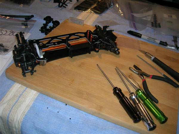

Anyway, I opened the box a month ago, and have just stared at it. All I did was put the bits in better zip lock bags, then put it all back. I read, and re-read the instructions, then put them back! I've built lots of race cars, buggies, off road trucks and done my fair share of fabrication and machining over the years. But I've never once assembled a model! In any scale or size. I played with trains as a kid (HO and N), but those came in a box, and maybe the odd one needed paint. So last night at about 7pm, after taking a trip to the hobby store and purchasing nearly $100 worth of "scale" tools, I opened the first bag of parts, commandeered the wife’s relatively new wood cutting board, and I then totally ignored everyone in my presence until 2am! Yep - it's cool.
I was so tired by the time I packed up for the morning, that I didn't take a photo of my progress. All I did in that time was assemble a couple of differentials (front LSD and an open rear??) and mounted them to the chassis with a driveshaft connecting them. But I'll tell ya, I'm really impressed with this stuff. It's very fun playing with this scale. Some things are a challenge, like installing E clips on shafts that are 1mm in diameter! Yep, my fat, tough of machinist fingers do struggle with this. Times and places I wished I had girl-y hands.

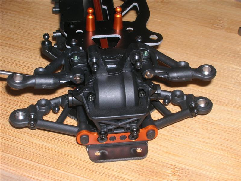

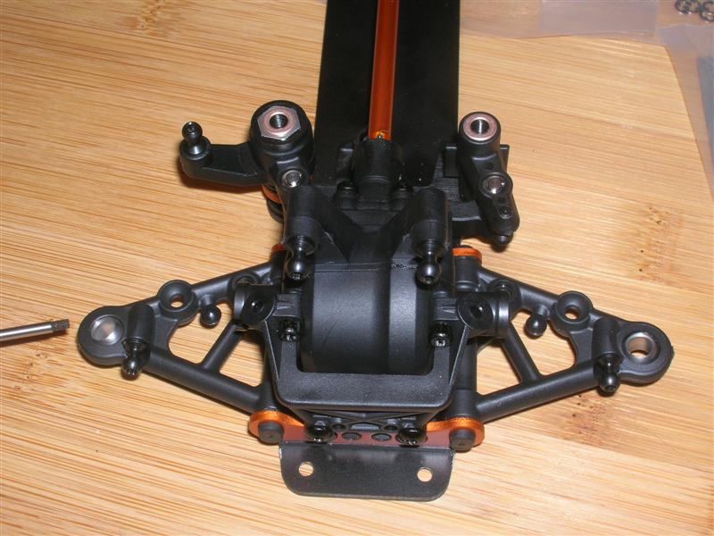

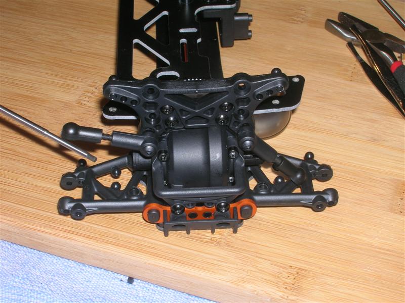

Well, here’s how day one ended; I was pretty prod of the diffs assembled, preloaded. I doesn’t look like much, but there’s over 4 hours of work in that little thing so far….
The front diff and the rear LCA mount (goldish colour)…
The rear diff carrier…

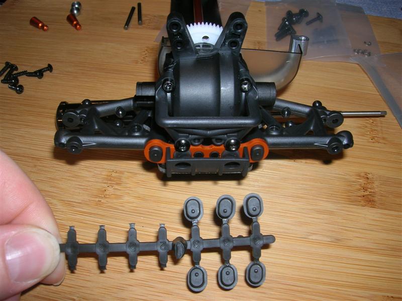

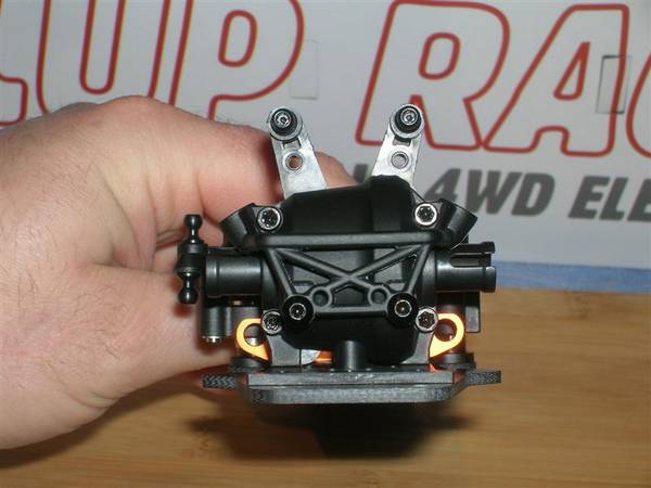

I started on the rear LCA’s. There is a steel pin that the LCA pivots on, and it rests in poly bushings at either end. The ball joint I’m pointing to is steel – screwed into the plastic LCA.
There are actually many different grades of plastic in the threes of parts, it really is interesting to see the various uses, but it all makes sense so far. The poly parts in the foreground below;
I liked the pressed in Ball joints for the spindle uprights. Also note the bronze bushes in the rear steer system behind the diff. there are actually 4 sintered bronze bushings here that the steering rotates on.

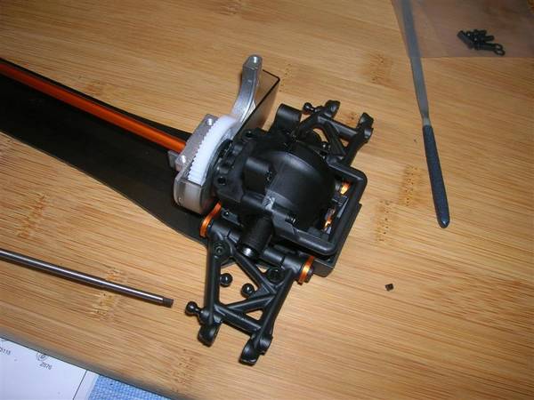

The front UCA’s added, as was a second layer to the chassis between the differentials to help stiffen the chassis as a whole.Same pressed in steel ball joints in the UCA’s. You can also see the pivot pins in the UCA’s – there’s even a tiny set screw (tiny even for this model) to stop the UCA pivot pin from rotating in the upper front X member to eliminate unwanted suspension movement that would affect the steering gear!

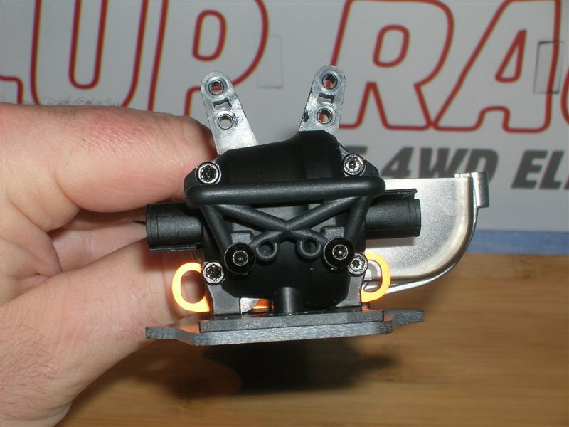

The rear suspension upper links are now installed, along with the chassis mount for the rear coil-overs. Note how you can even adjust the rear camber on the upper rear suspension link.

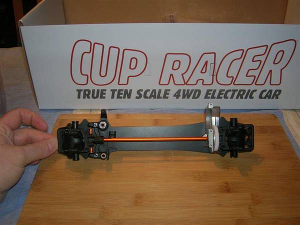

The chassis at the end of day 2:
