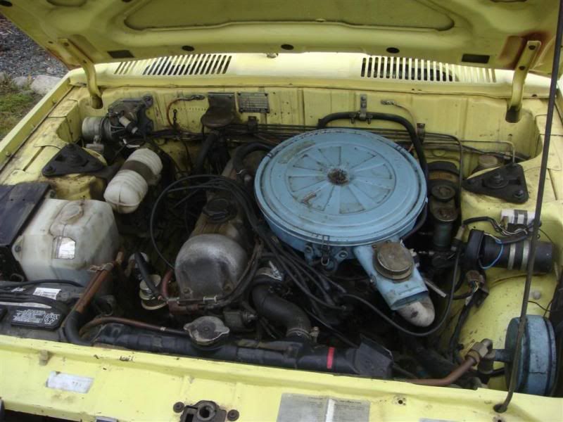

Now THAT is one fine car. Love the looks. There's a 76 California 'goon near me in similar shape. (sigh)
The '76 standard and automatic 710s had an H-165-B axle with 3.70 ratio, so not the same as the 510/610. Leaf springs are easy to lower or stiffen to suit the ride you want.
As for the front here's that California one near me. It does have the adjustable camber plates.
[url]Image[/url]
There is no easy way to change from an automatic to a standard unless you have a parts car beside your house with all the pieces needed for the swap. You will need:
Clutch and brake pedal assy... may also need the gas pedal as well.
Clutch master cylinder. You can make your own hard line.
Slave cylinder and push rod... may come on the replacement tranny.
Clutch actuating fork, rubber boot , spring clips and release bearing housing or collar.
A 6 bolt L or Z series flywheel and a clutch to match. Cars with L20Bs have a 200mm flywheel and clutch assy, L20B trucks and 280z and zx are 225mm and 720 truck 4X4 and all Z24 motors use 240mm. Any size will do for an L20B in a light car. You don't have to use a car 200mm flywheel.
A $3 pilot bushing for the flywheel end of the crankshaft.
extras shifter lever and boot.
