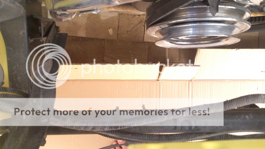

Finally got my self to work on my project. I finally installed the new fan, but unfortunately, to no avail. The engine still heats up. I believe I need a larger or more efficient radiator.
I captured this image that shows the fan while the engine is running, to show how close it is getting to the engine. It barely fits.
I believe I have to replace my radiator with a larger one. Looking at the bright side, it means I'll retain my planned power steering plans, because I'll be using the previous low profile fan.
This fan didn't feel like it is blowing any more air than the flex-a-lite that I had, although it is supposed to blow more than twice as much. It sure didn't feel like it.
Also, an annoyance, whenever I leave my car without running it for a while, air seems to find its way into the break and clutch lines. Driving me crazy, I assume the fluid should leak out, not the air leak in. Never seen that happen before.

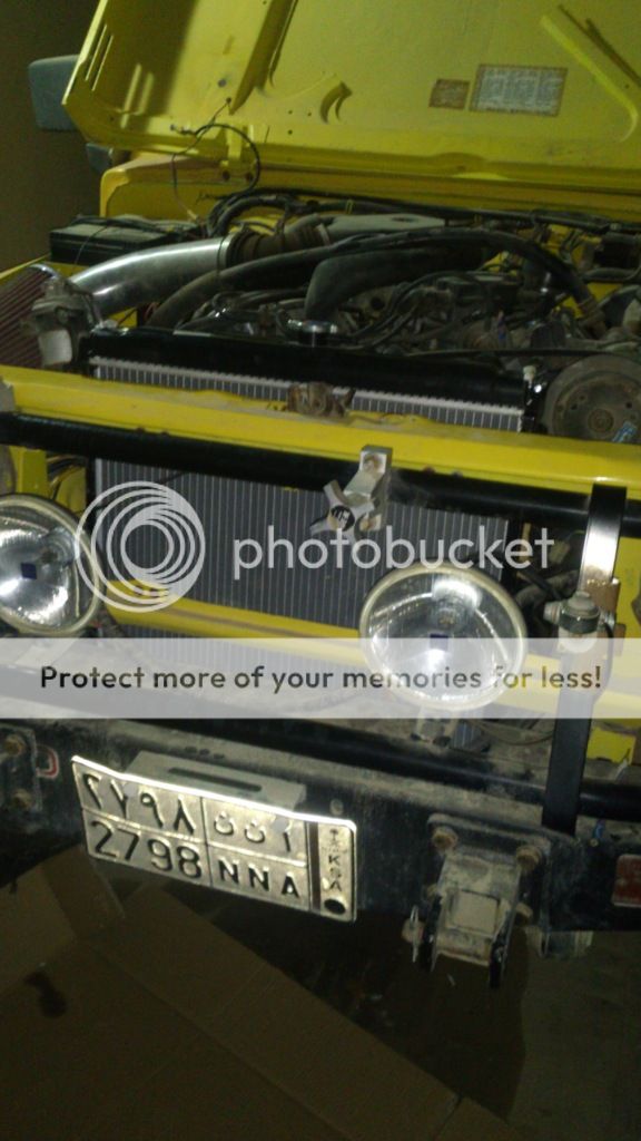

I found the right radiator for the Samurai. It's the 2007 70-series Land Cruiser radiator. This car is foreign to you guys in the US, because "it doesn't meet your safety standards"
The radiator is slim and tall, and drops just right between the frame rails. But I will have to get rid of the steering stabilizer, unfortunately.
Also, I'll have to cut out a piece of the radiator and then weld the exposed pipes off, to fit it around the steering box. I don't feel like finding a box that would fit on the outside, then have to do a whole lot of work getting the steering linkage over there and all that head ache.
I planned originally to make everything bolt-on. Unfortunately I am going to have to deviate a little from my plan, but I want to deviate as little as I can.
Here's a picture:
This radiator is massive, designed to cool off the 4.5 L Inline-six engine of the Land Cruiser.
I will have to improvise a way to fit the A/C condenser though, but I'll worry about that later. Wish me luck.
Also, once the radiator is fitted, I'm planning on getting this fan, which is a perfect fit for the radiator and perfect thickness for my narrow application.
Here's a picture:

Ok, a quick update:

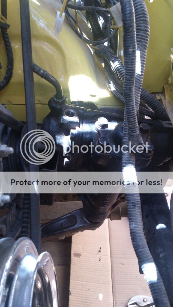

I got a power steering box from a Suzuki Jimny, which bolts right on to the Samurai frame:
Then chopped off the steering stabilizer:
Dropped the Land Cruiser 76 series radiator in place:

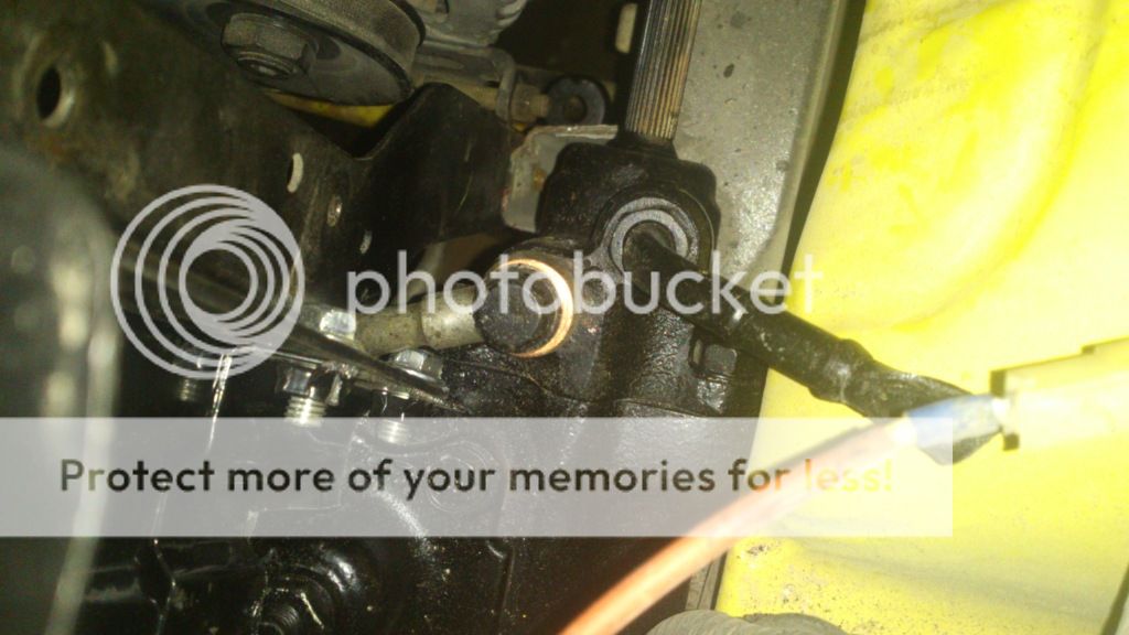

And hooked up the power steering box to the power steering pump using hydro lines from a Nissan Cedric, which turned to bolt right into the Suzuki Box like it was made for it! Those Japs work together when they build their cars!
The eye bolt from the Nissan bolted right into the steering box, exact right thread.
Hydro line routing:
And into the Nissan Cedric power steering pump:
It all worked out quite well. Still have yet to get the electric fan, then I can get the Zuk started and running.

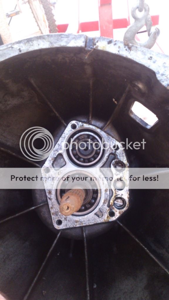

Some updates regarding my transmission problem.
I tried to take the transmission out without touching the engine, but it turned out to be impossible, because of the tight Samurai body. So I had to remove the whole engine in order for me to get to the transmission.

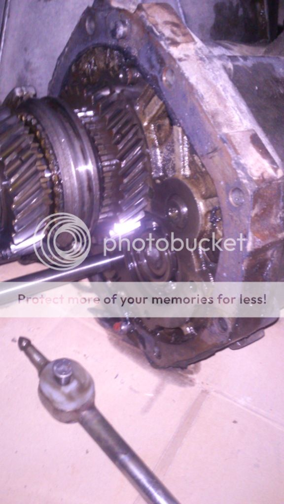

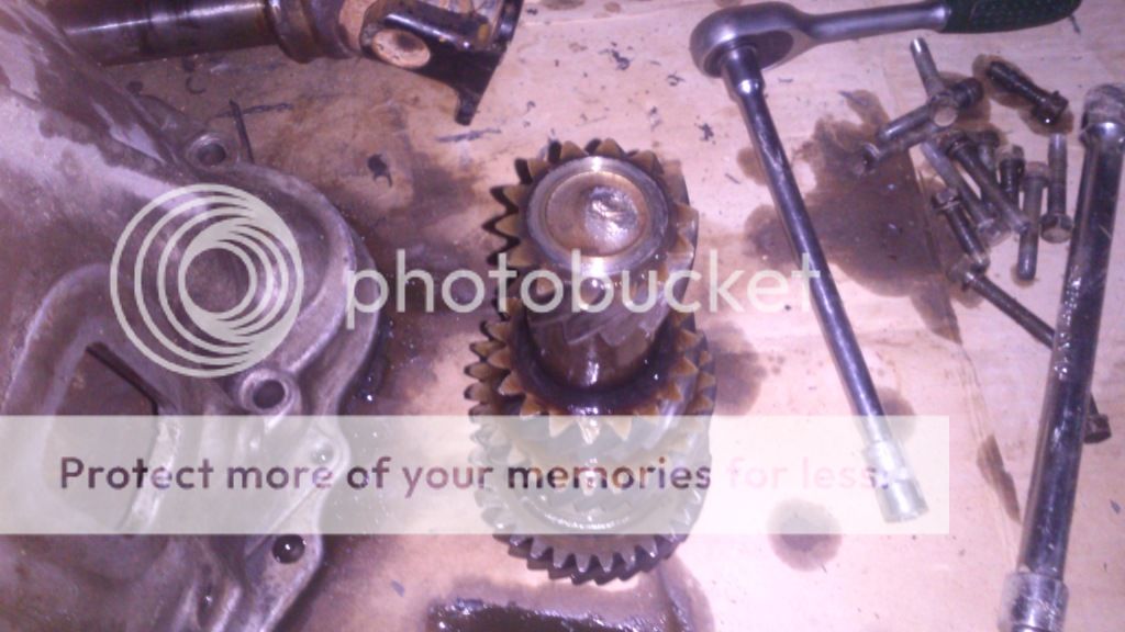

After removing the engine, I took the transmission apart, to find that the counter shaft was broken.
The broken part:

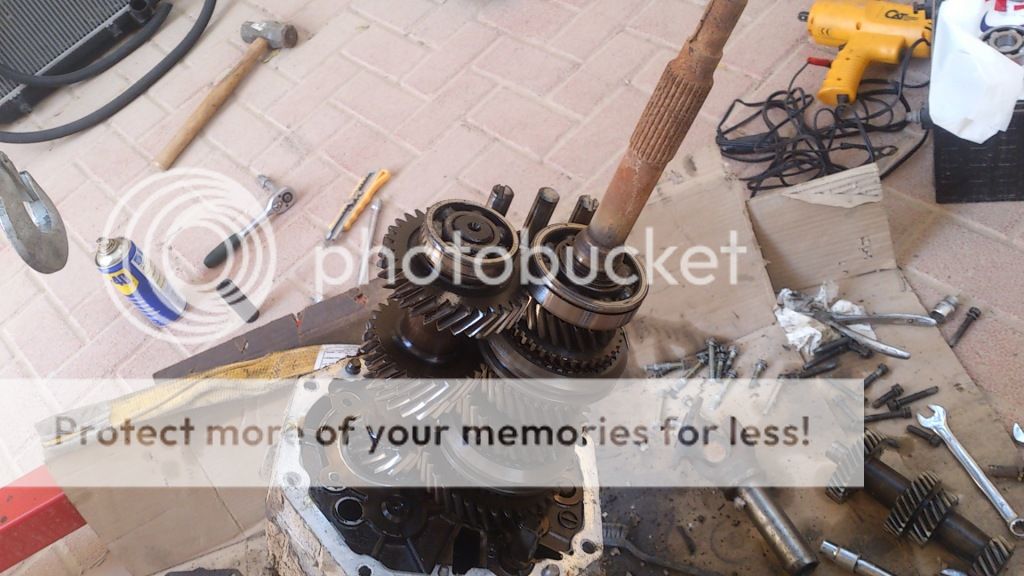

The reason it broke is because of a mistake I made when I swapped the transmission shells (bell housing). The bearing of the counter shaft was smaller than the bearing retainer hole, so that caused some play in the counter shaft:
So I bought a replacement transmission, which turned out to be in really really good condition, and took the housing off to swap it out:
This is the new transmission. I went out and searched for a larger replacement bearing to avert the previous mistake. I had some difficulty finding one, as most bearings shops did not carry the size I needed. Eventually I found one, and here it is:
Notice the difference in size between the old one and the new one.
The new transmission after fitting the new bearing:
The broken part:

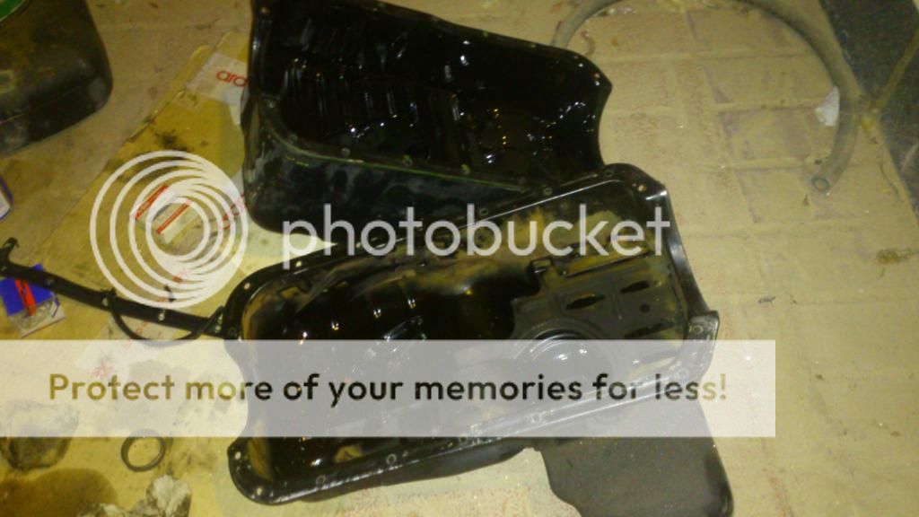

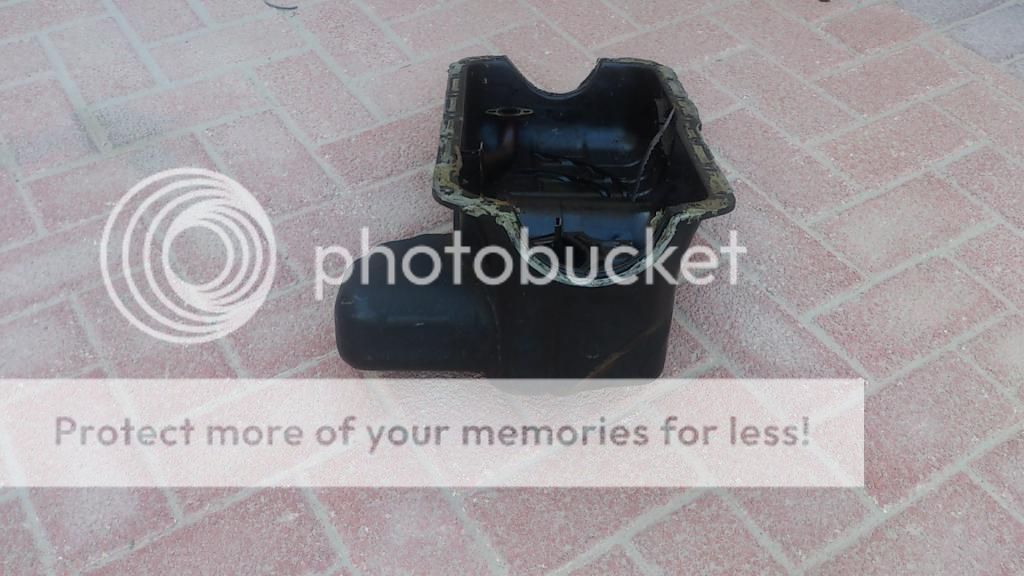

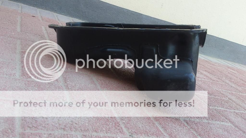

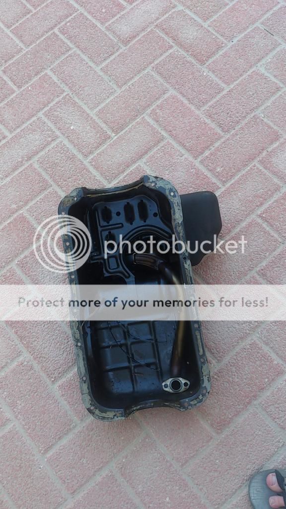

I've bought a 90's Nissan non-turbo 300ZX oil pan to replace my current oil pan. The current oil pan has the hump in the front of the engine, which interferes with the steering links and might get struck by the front diff.
Here's how the old oil pan looked like:
My Nissan non-turbo 300ZX oil pan off e-bay:
This will provide ample clearance from front diff and all the steering links.
So I installed the 300ZX oil pan and oil pickup now, and it fits almost perfectly, except where it mounts to the oil pump, the bolt holes (four bolts) were slightly off alignment, so I thought the pan is rigid enough to keep that area shut, with the rest of the pan bolted shut. I thought of drilling holes, but it was very difficult to get the correct measurement. I'm not sure why they didn't align, but my guess is that my pump and engine is from the 80's models, and the pan is from the 90's models, so probably there's a small difference in the oil pumps.
Got the old oil pan off, now both pans set side-by-side to see how they differ:
The two oil pickup tubes, side by side:
I had a small problem, the front diff didn't provide enough clearance to remove the old pan, or to install the new pan, so I devised the following solution:
Lifting the car off the axle from the bumper with the engine hoist, to clear the oil pan.

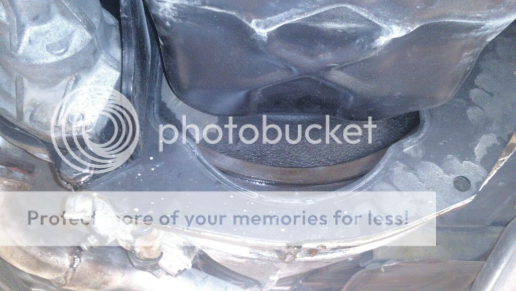

Oil pan securely in place, and best part is that it is now blocking the hole that was exposing the flywheel with the old pan. I was so pleased with this positive side-effect:
Old setup:
New setup:
The new pan perfectly clears the front diff and steering links:

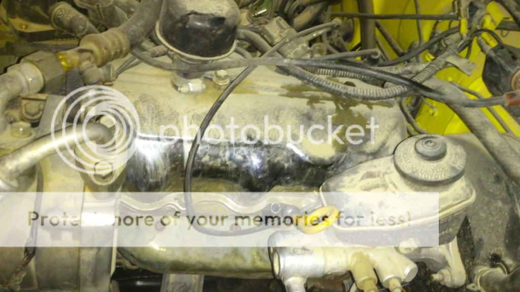

Also relocated the dipstick pipe. The VG30 engine has provisioning for three different dipstick locations, one in the front right side (the original location in my engine), one in the front left side, and one in the rear left side. My new oil pan needs it to be in the former, left-rear. So I punched off the brass plug, then I had great difficulty taking out the pipe from the original location, as it seems to be pressed into the block. After many attempts, I finally succeeded with great difficulty. Then the problem arose when I need to press it into the new location. Of course that would be impossible, so I sanded off a layer of the pipe until it was thin enough to be tapped into the new location with a hammer. That worked.
Old dipstick location:
New location:
Notice I had to notch the heat shield on the driver side to allow the dipstick pipe to come through.
Old setup:
New setup:
New location:
