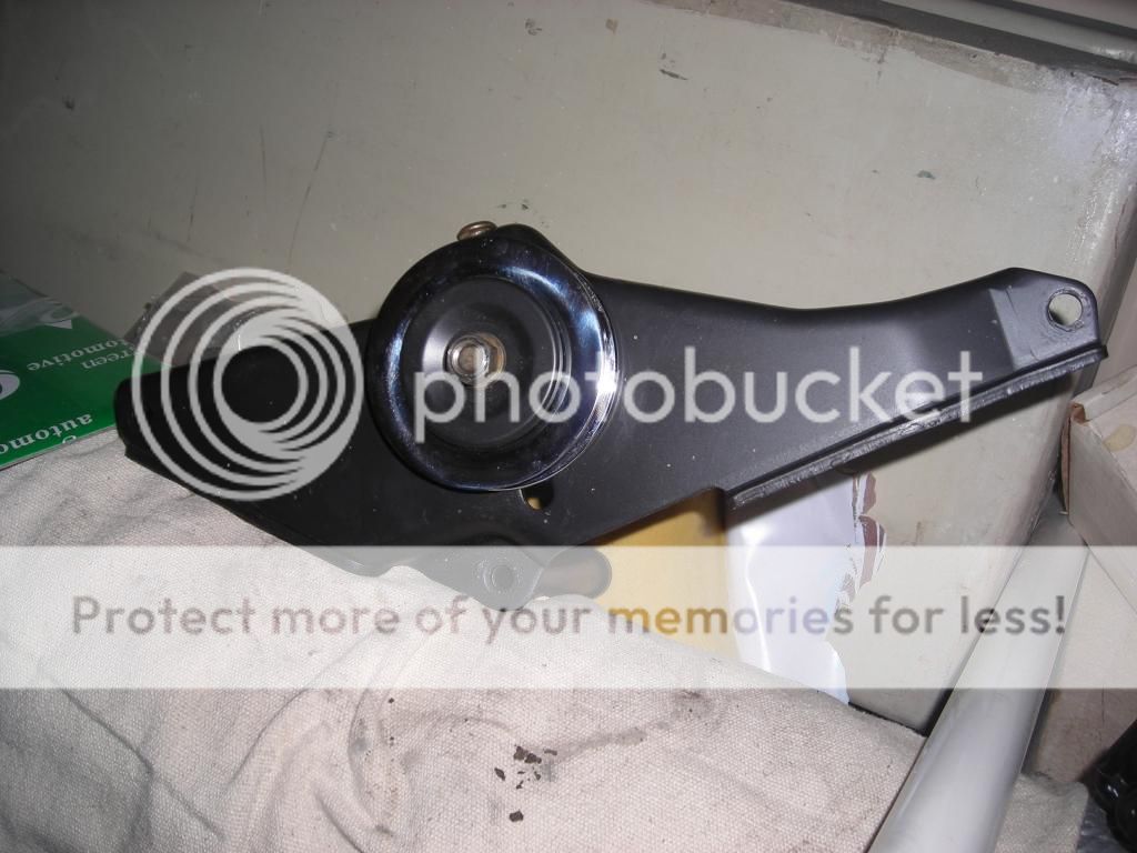

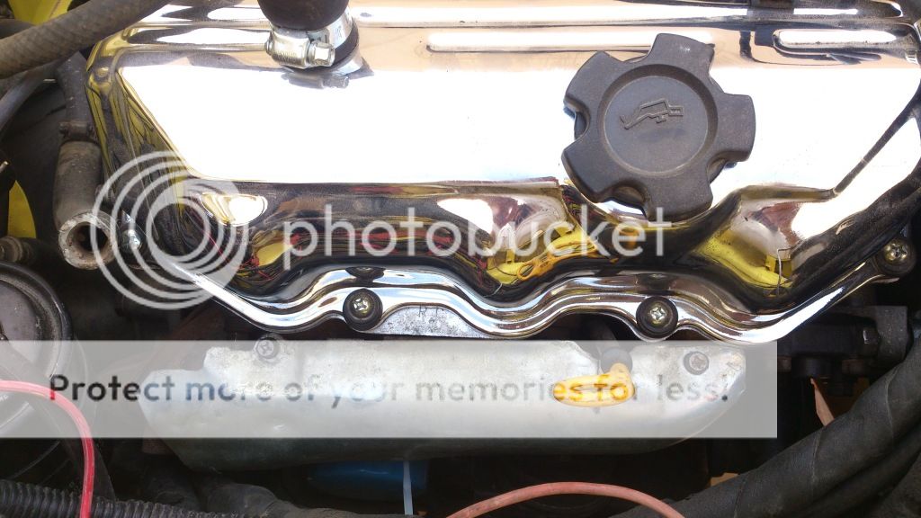

While I wait, here's a small teaser; chrome fantasies! Chromed A/C compressor idler pulley, with new bearings and painted bracket, FYE only:

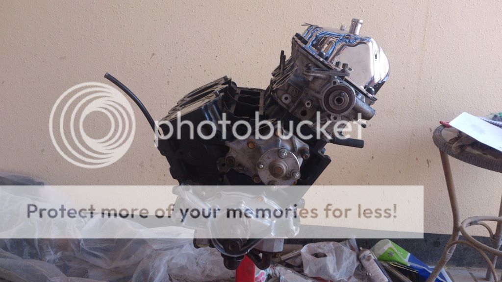

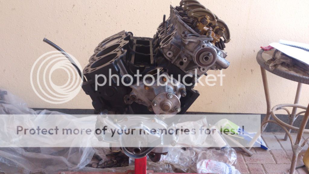

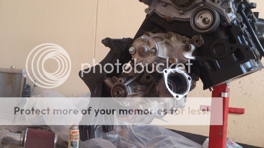

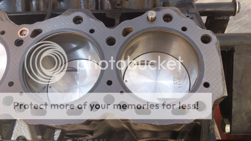

I can't wait for the replacement piston and rings to arrive, so I assembled the good side head to see how it will look like. I couldn't resist.
The head gasket, before assembling the head:
The head is on, but without the valve cover:
Installed the valve cover:
Installed the A/C and alternator bracket and the thermostat housing:

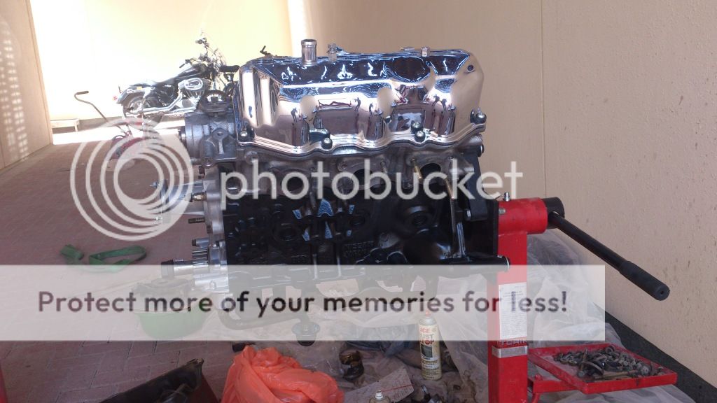

I finally received the replacement piston and rings last Saturday and immediately went on to completing the engine:
Second head installed; timing belt fitted with new tensioner pulley.

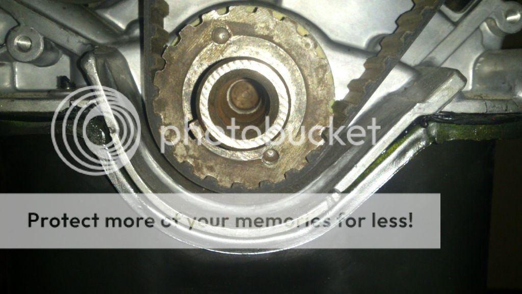

Also, while I had the timing belt sprocket off, I went to a machine shop and drilled/tapped two holes, so that in the future it would be very easy to pull out using a pulley puller.

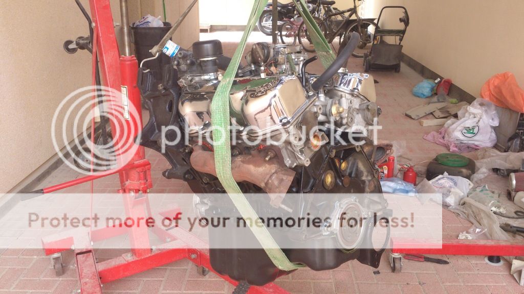

And finally, the engine is all set and ready to be dropped into the car:

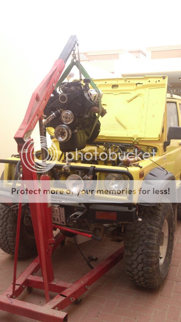

I picked up the engine with the engine hoist (nevermind the background mess, all to ensure a perfect job
Installed the flywheel, clutch, and pressure plate:

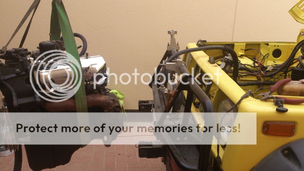

My zuk, facing it's new engine:
In it goes:
I had a very hard time slipping the transmission shaft into the clutch assembly, considering the tight space I had.
The engine now sits peacefully. Will send a picture tomorrow, since I only finished the job at night.

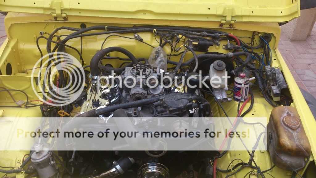

Ok, finally the engine is seated:
Right engine mount, I used a Land Rover Discovery engine mount, which turned out to be quite a perfect setup.
Left mount:

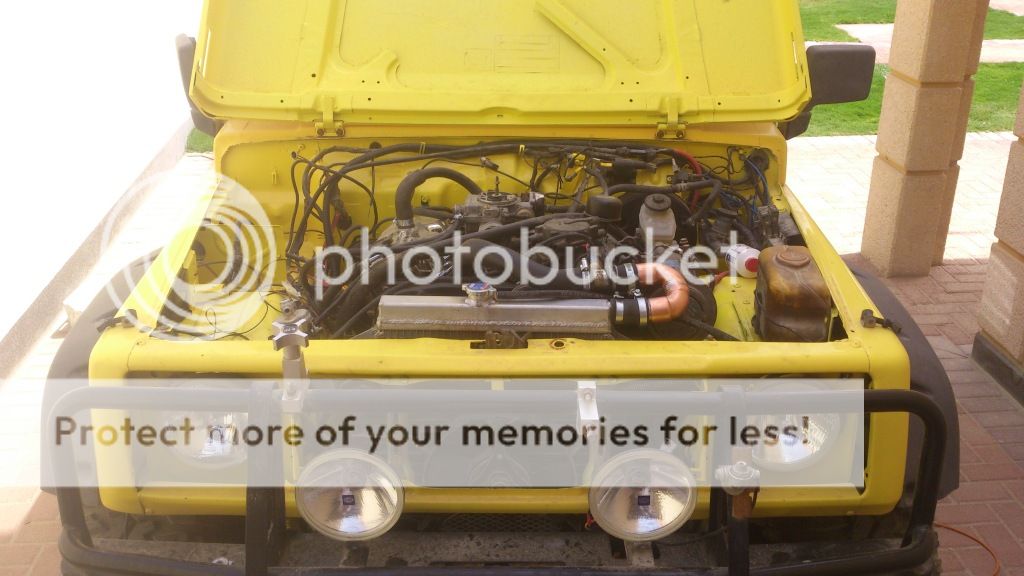

Finally, the engine is almost ready to be cranked up. The radiator has been installed and all fuel lines and vacuum/vapor lines.
Barely enough room between the engine pulleys and the Flex-a-lite electric fan:
Had they not made such a low profile fan, I would have had to use a pusher fan.
Now, all I need to do is to fill her up with coolant, hook up the battery and exhaust pips, and everything will be ready.

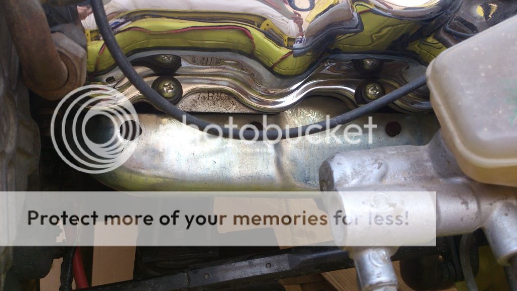

I have galvanized the exhaust manifold heat shields, to protect them from corrosion and give a nice look under the hood:
RHS exhaust:
LHS Exhaust:
Also, I finally turned the engine over last night, and it ran ok, but my distributor rotor is completely worn out. I don't want to continue running it till I change the rotor and cap. Should be arriving tomorrow.
