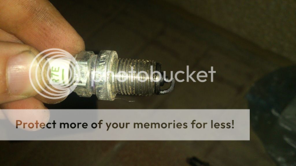

Well there's good news and there's bad news.
The good news: the new harness works well and all my electronics are back to normal.
The bad news: I don't know what happened to my engine. It stopped for almost a week until I got the new harness installed, but when I ran it yesterday, it was running very rough with very poor throttle response. I have no idea why it's doing that, last time I ran it it seemed perfect, very smooth.
The engine seems to be running extremely rich, I can smell unburnt fuel from the exhaust. I checked the ignition timing, not changed, I checked all spark plug wires, all are giving good signal. I haven't checked my spark plugs, by my guess is I'll find a few that are wet.
It feels like a carburetor problem, but I haven't touched that since my last time at all, everything is exactly the way it was.
I need advice on where to look. I'll go and buy some new spark plugs, but I got a feeling it is not a spark plug problem. I'll replace them because so far I've been running old ones.

Post by okayfine » 08 May 2013 06:36
Plug condition may tell you something. Pull 'em and post a picture. Note if they're all the same condition, or if one or more are different.

Post by iniazy » 08 May 2013 09:29
okayfine wrote:Plug condition may tell you something. Pull 'em and post a picture. Note if they're all the same condition, or if one or more are different.
Yeah, that's what I just did.
Too bad, seems I must have made a serious mistake in my engine rebuild.
Two of the plugs, #3 and #5, were completely wet with engine oil. One, #4, was dry but completely fouled. The other three were good.
Here's a picture of one of the wet ones:
I'm going to do compression testing to see where the problem is. But most likely I am not going to rebuild it again. I'll just get a JDM engine and bolt it on. I'm disappointed with myself.

Post by okayfine » 08 May 2013 09:31
Compression and then a leak-down test will likely isolate the cause (rings, valve seals, HG). Something to learn, and potentially not an engine killer.

Post by iniazy » 08 May 2013 10:53
What's a leak down test?
I am very frustrated because I really didn't want to tear my engine apart again! And the most difficult part is removing and dropping it back in.

Post by okayfine » 08 May 2013 12:05
Compression tester just tests compression. Leak-down pressurizes the cylinder and measures the amount escaping. From there you can hear if it's coming out of the exhaust, through the valve cover, etc.
