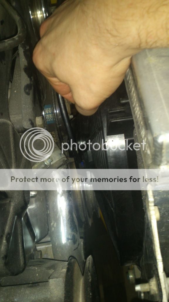

Finally received the fan. Here's the fan I ordered:
It's got a massive motor, really big and took so much room. Bye bye power steering
I hope I don't have to do without the A/C compressor too.
It almost touches the water pump screws. If this doesn't do it, then I'll have to replace the radiator, I think.
