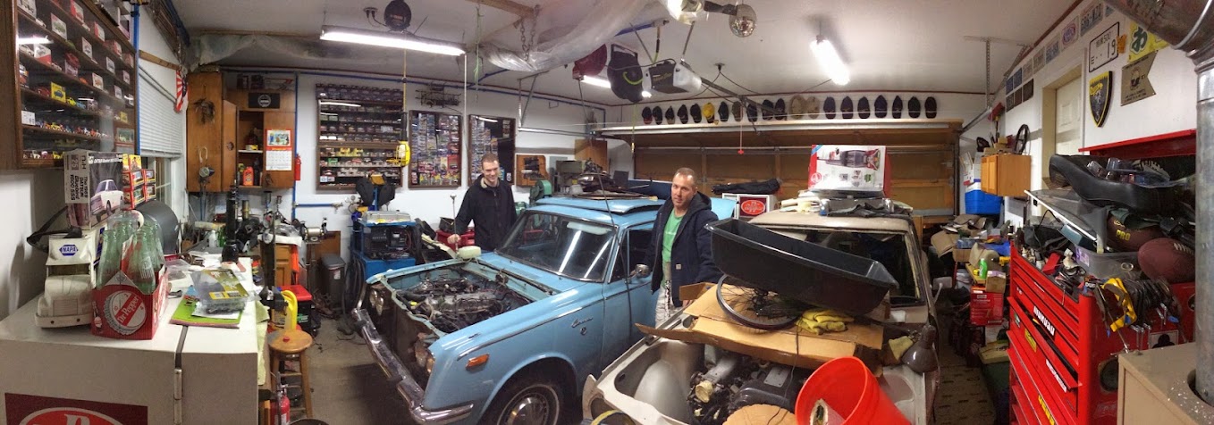

Today Jeff came up from Everett and wired the toyota 22RE, I can't thank him enough! A local friend, Chris, came over too and collectively we got it going. It's always nice to see one fire up for the first time in a project car.
Engine mounts: I kinda figured they would be too rigid when I fabbed them up, and they are. I have a feeling it's going to vibrate it self to death if I don't do something about it, but it will be later.....I still have to install the electric fan and wire it, install the throttle cable and sort out the clutch and brake pedals. I also nneed to tidy up the wiring, pull out some of the old stuff and finish wiring the alternator then I should be able to drive it. It's getting close!!
