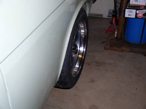

If you do plan to go with a new rim, the 15x7 +20 with a small spacer up front should fit your car using a 195 or 205/50-15 tires. The fender lip may need to be rolled with the 205 tire, depending on the ride height you end up at.
FutoFab sell a 15x7 +18 in the VTO Retro 4 (silver) and the Lemans (gray). We did a quick trial fit these wheels on a stock fender 510 and with 205/50 Dunlop Direzza Star Spec tire and the clearance is tight. I would anticipate rolling the fender lips especially if you plan to use the car on track.
If you are looking for a sure fit, go with a 15x6 +24 w/195/50 tires and use spacers to compensate for the 280ZX hub placement. These fit an unflared 510 w/o rolling the fenders.
Here are pictures of the 15x7 +18 Lemans w/205/50 Dunlops on the rear of a 510 2 door (the car is on jack stands).
