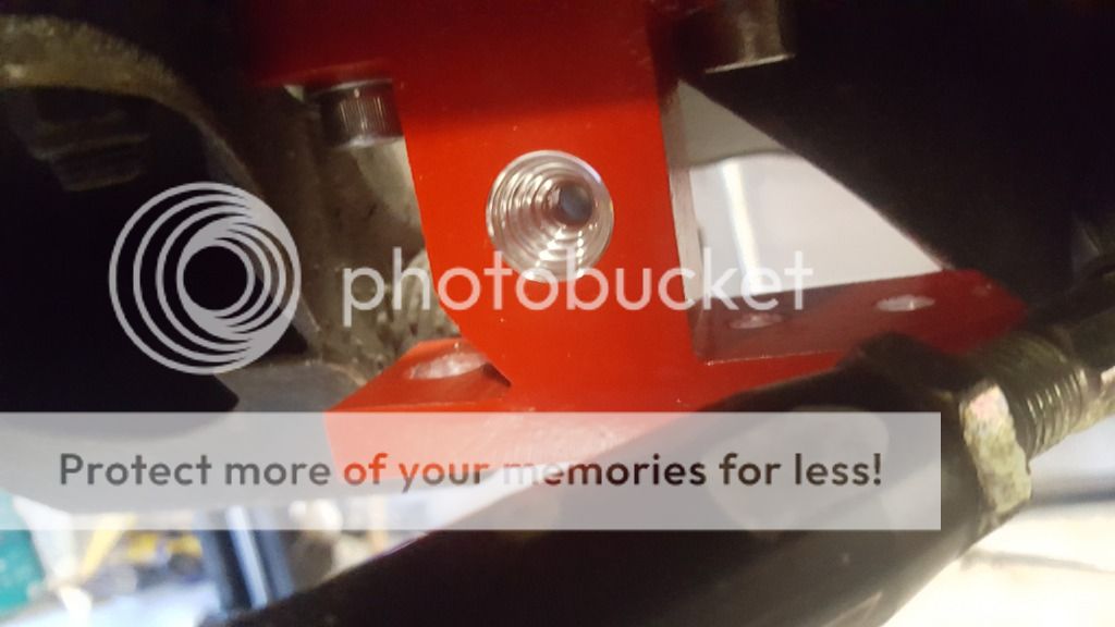

Well I went by one of the local boat builders today. They have a full machine shop so they are going to make me some standoffs and bend the sway bar for me. I will just need to get myself some endlinks and I will be set.

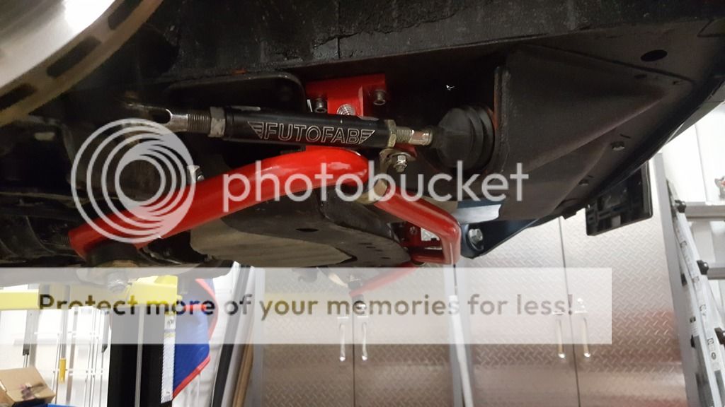

I have been working on getting the re-profiled sway bar installed. It fits nicely and end up in a good spot under the control arm. Now I am on to end links.
I am going to cut on the red line to make room for the link to move without contacting the control arm. I'm pretty sure it won't affect the integrity of the arm. They are stout pieces.
I will use this as a link.
It gives me enough adjustment that I can get the sway bar as close as I want to the control arm.
I now have to pull the sway bar and stanchions off and pretty them up while I wait for the links.

well I got it all cleaned up and installed. I decided to paint it all red, my son keeps asking me to put something red on my car so there you go.
I have it installed with the old end links but the new ones are on the way. There is minimal preload on it so it will be ok till the new ones gets here.
As it sits the end of the bar is just above the wheel rim and with the links on it now the ends of them are well below. I would put a nice grove in the pavement if I got a flat right now. The center part of the bar is just below the cross member by 3-5mm. It turned out pretty good I think.

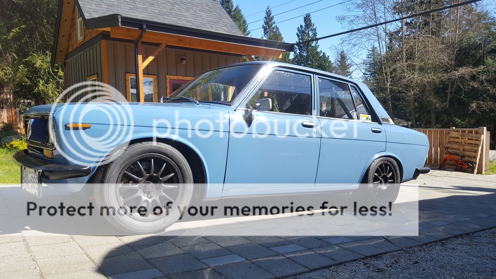

I got a few pictures of how she sits today.
I really love my car.

Looks really potent, nice colors. Is it just a bit high in the front or is that "what it is"?
Posts: 957
Re: 2.3L of fun
Postby funwithmonkeys » 02 Apr 2017 20:31
Thanks Joel, I have to take a ferry to get anywhere other than the 80km of highway here on the sunshine coast. I can't go much lower without scraping the front of my car if the ramp operator doesn't do a good job getting it level. I really like the look of it at this hight. I will not be going Icehouse low.
