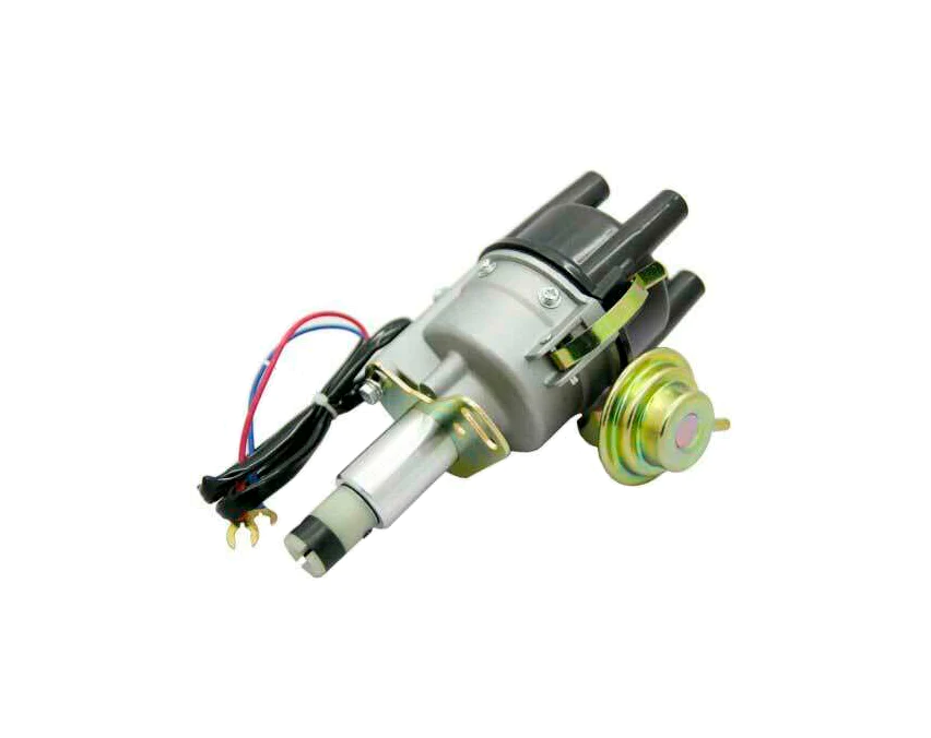

So Santa brought an electronic distributor and a new coil. Yay! I have no clue what to do with them. Well, I mean beyond wanting to put them in my car! There are no rules included and I've never dealt with an electronic distributor/ignition so I have no idea if it's complete or how to install, or if I need to change wiring or what. I've seen the terms "Pertronix", "Matchbox" & a version of a GM HEI but I don't know anything about them or if this is the same as one of those systems.
Can anyone point me to some reading so I can learn about how to install, etc?

I don't know, it seems to be unbranded. It came from ZcarDepot.
https://zcardepot.com/products/copy-of- ... f22c&_ss=r
It seems to be the same as this one? https://www.hot-spark.com/1-HS-HIT4-Distributor.htm

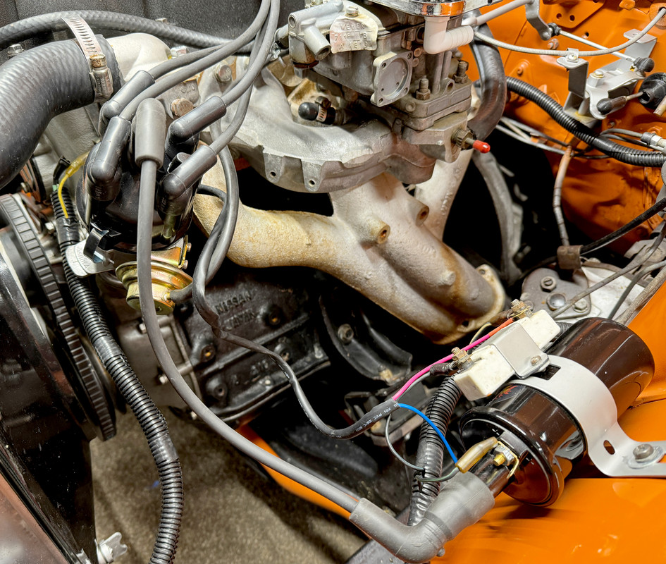

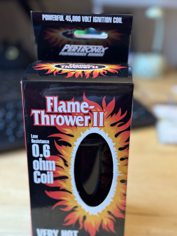

So, I spent New Year's Eve day working on my car. I installed the new electronic distributor and coil. I followed the directions at Hot Spark and it works! Yay! I had to exchange the coil hubby bought for a 3.0 resistance one, and use the stock mounting plate/new O-ring on the new distributor; otherwise, it was straightforward and the car started right up. It runs like a champ. I won't be able to fine-tune it until spring (we just got snow 2 days ago; figures) but it runs smoothly sitting there! The top end sounds a little clackety so I need to do some reading & see if I need to make some adjustments in the head or something.

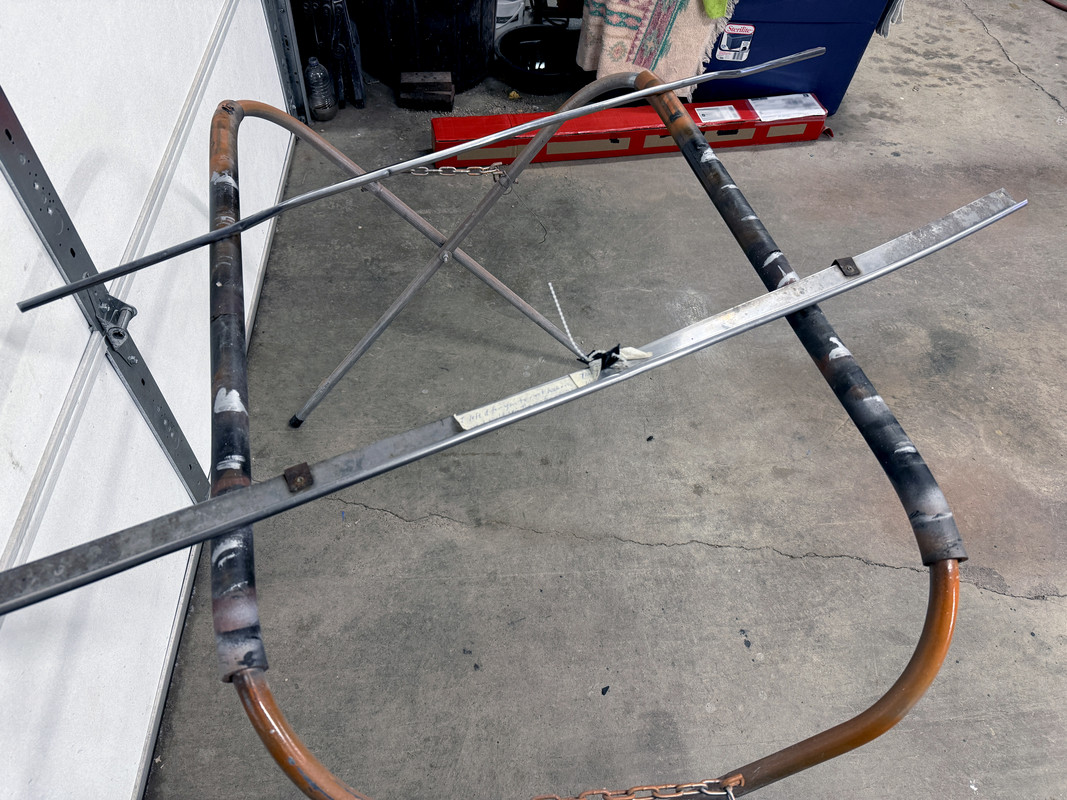

I also finally found hood trim, in Canada, of all places! Woo hoo! It had 2 dings in it that I massaged out last night but one of them is right behind one of the mounting tabs so I can't get to it very well to get it smooth. It's better than it was but it's not perfect there. I wet-sanded and polished the hood trim and the lower gill piece I got from Iceman510 and with a little more love, they'll both be ready to go on the car. I'm so excited, it'll really make the front end shine!
With some careful judicious prying you can get those mounting clips out. Easiest on the ends, not so easy for the middle ones. Finding a perfect piece is really hard. I recently acquired one from Washington state that needs a little love too. I have a perfect one that I powdercoated black years ago (which I somewhat now regret following that trend) along with all the other front trim. Not sure if it could be feasibly stripped, but probably don't need to now.
